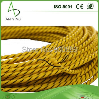

Ali has a leakage sensor that is built as a belt. It measures a water outlet over the entire length. I laid it in loops under the aquarium and connected it to a Neo Coolcam window contact. As soon as moisture has been registered somewhere, the sensor triggers.
A similar product from Switzerland.
or Busch-Jäger
