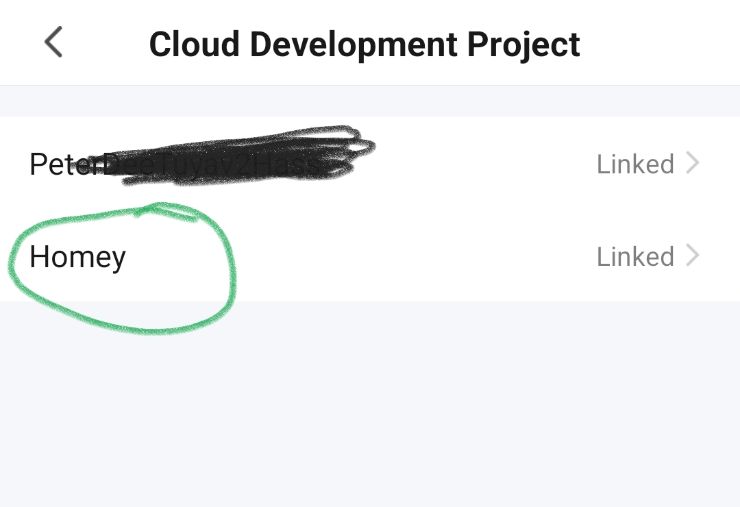

It should, but it’s hidden under “Cloud development project” (same location where Tuya Cloud app iot project resides):
When you’ve installed the test version, and the login screens appear only once when adding devices, you’d see Homey linked as well.
Thanks Peter, with the latest version it is working, provided I log out, close the app restart, restart Tuya. I could my smoke detectors, but alas, only ZHA appears as a linked project, cannot get Homey to show up, and I have to relog every time I need to add a new device.
