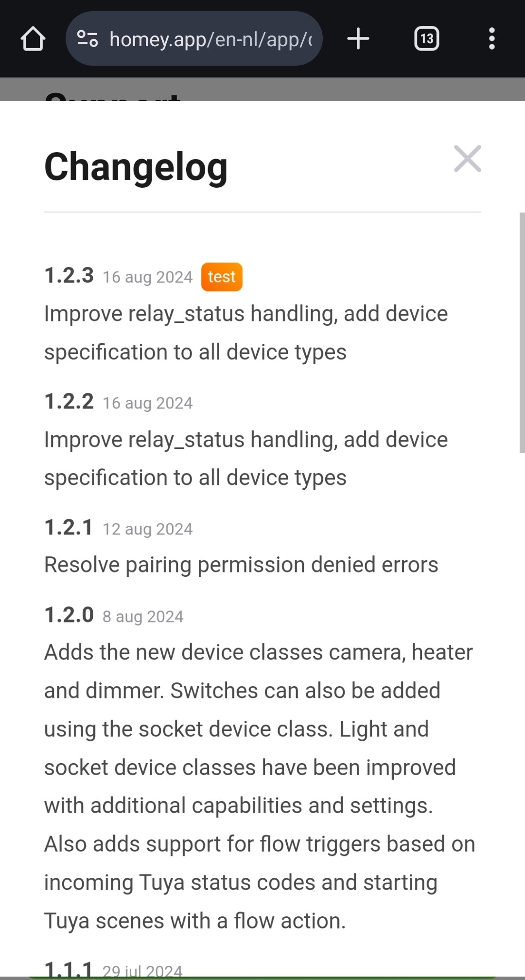

It’s not in the “live” version yet

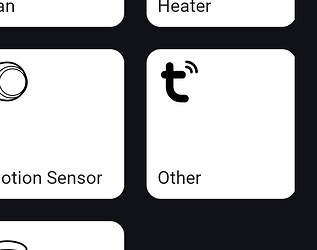

Hi German,
When you cannot add your device as “other” device,
it is most probably not yet added to your smartphone app you use, TuyaSmart or Smartlife.
Hi Peter,
but they are both added to my SmartLife app. :thinking: That’s why I don’t understand why can’t I add them to Homey… :face_with_raised_eyebrow:
Thanks for your help!
YW!
I see. I don’t know what’s wrong there.
What if you test this:
delete one of them and add it again? Maybe Homey finds it this time.
Just a brainfart…
Or restarting the Tuya app @ Homey, or Homey itself might help.
Thank you Peter!
once I deleted the fans and added them again in Smartlife it solved the problem!
I have sent the request to add a new device.
Thank you for your help! Have a fantastic day
