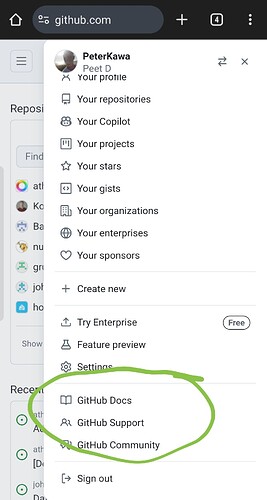

But you can delete each revision, can’t you?
Thank you very much for letting me know about this!
It would be nice if Athom communicated these things to users.
The impression I got from 4 “Homey years” is:
I guess Athom assumes you do your own part of educating yourself, and dig up the “how to Github” manual.
Forgetting / ignoring the fact most Homey owners aren’t (very) experienced coders / Github / Forum users.
Yeah I have seen this option. But it’s very complicated and not user friendly. You have to agree that using scenes should be a lot easier to use.
I agree it’s complicated at first. It"s just a quick shortcut to be able to control (still) unsupported devices for the impatient.
Just keep using the Tuya Cloud community app I’d suggest, until the Athom app really sets off by supporting all tons of different Tuya devices out there :wink:
(Both apps can run side-by-side)

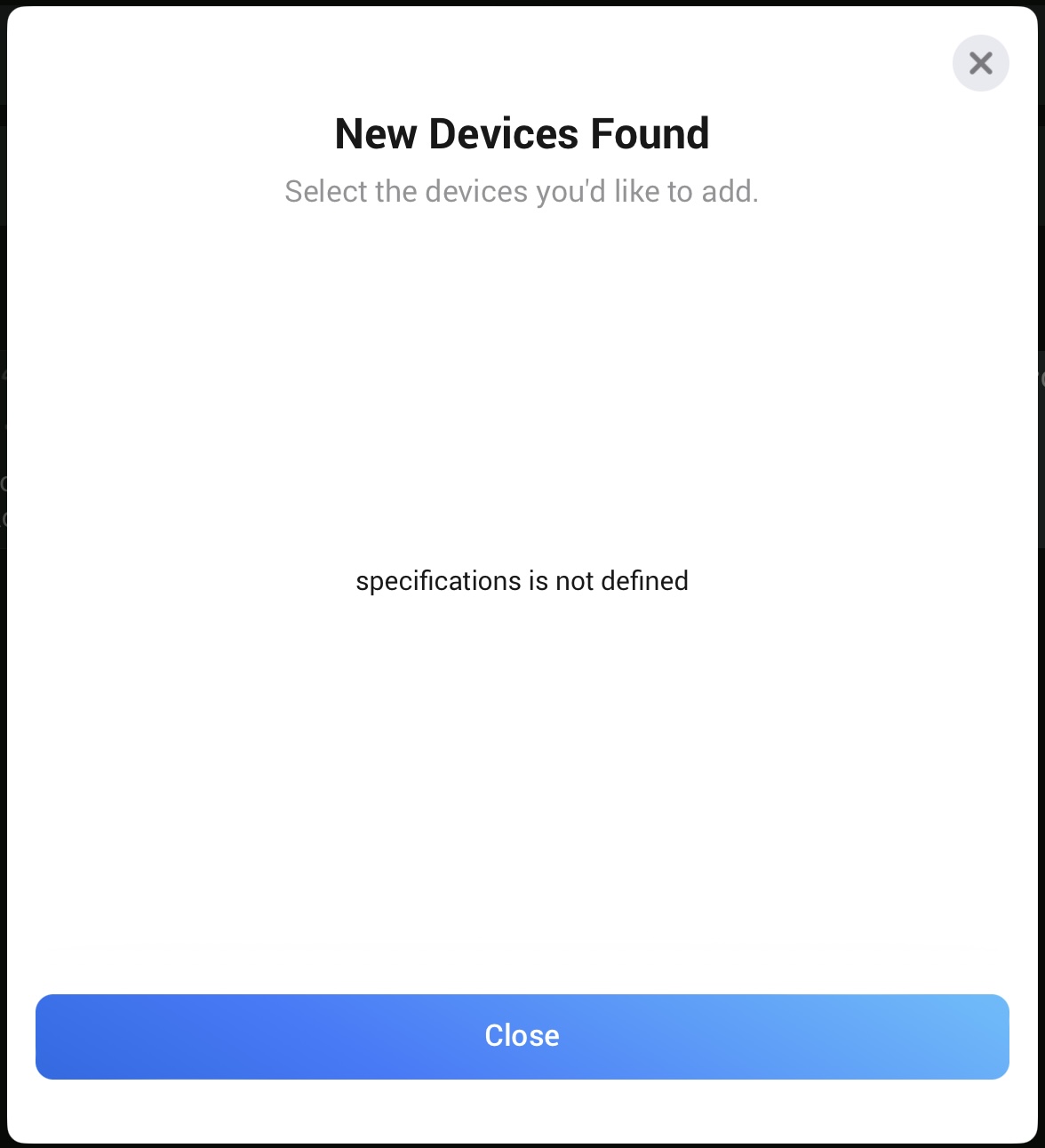

Thanks for your continued work on the Tuya app. V.1.2.0 seems to have regressed for Fans. Readded a fan using this new version and get “specifications is not defined” message. Reinstalled v1.1.1 and could add / all ok.
