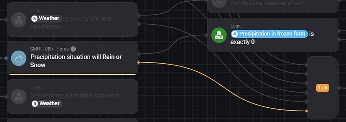

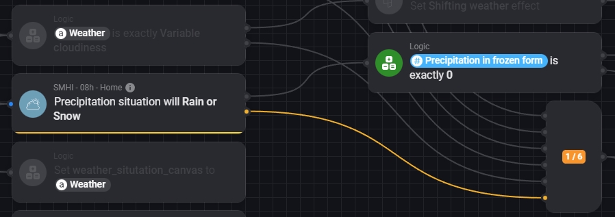

I am still getting issues with both my flows and the weather situation.
The last issue I “fixed” by checking for the precipitation situation, but now the issue arises again.
The weather situation is Variable Cloudiness and that is one of the flow cards, but that returns false for some reason.
Maybe there is an issue between how the Weather Situation and Weather are linked?
Should be the same imo.

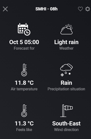

EDIT: Today it became more apparent, Weather situation vs Weather, are not the same.
EDIT nr2: Today this happened again with the Precipitation situation.
Flow is False but the 08h-device shows Rain.
Am I missing something?
Is this supposed to be like this?
