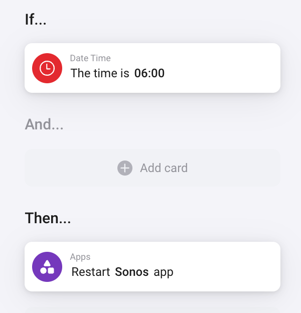

Unfortunately, it’s a known issue since years. I don’t know if every user has this problem, but I do. And of course I have already reported this problem to the app developer Athom.
Therefore, please report this problem to Athom as well. :pray:t3:
A workaround that works is to restart the app once a day. This can be done with a flow:
thanks, I reported that!
however this restart is not always good, because I restarted it 2 hours ago and that not working again, so I had to restart it in every hour XD
For me it works indeed, when I restart the App once a day.
Maybe there are also some other factors causing the problem, e.g. the home LAN/WLAN.
Do your Sonos have a fixed IP address?
