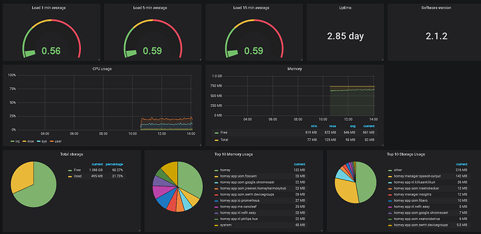

This is definitely not normal. It will add some CPU load of course but it should be nowhere near a full core. Can you isolate the problem to the CPU load to the Prometheus app?

Did see an increase when i turned on Prometheus, but not the big increase that im used too, i deleted 6 devices from the Nest app and Lifx app yesterday, maybe there’s an connection there. will test that.
Thanks! Got the report, but everything looked pretty normal there. Also, your Prometheus config looks good. 101 devices is a bunch, but with just over 60 devices, I can hardly see the change in load average. Most of the CPU consumption is event driven (polling is only done for system metrics and should be fairly constant). I am thinking maybe some device is spamming the Homey with state updates? I will think about if I can add some more self-monitoring metrics such as time spent in event handlers etc. Should help track this down.
On master I now added exporting of basic self-timings by adding two metrics (one for time (user/sytem/real) and one for call count). Should help identify the reasons why any spikes in CPU usage happens and in correlation to what.
When i use the profiler i dont get any CPU usage had it running fot 5mins. The mem is constant: 27.1MB
i dont get any CPU usage for any app by the way.
Cant think of an device which is permanently spamming homey, have some on a 60sec. interval, is that al lot?
Will wait on the new master then for digging deeper.
