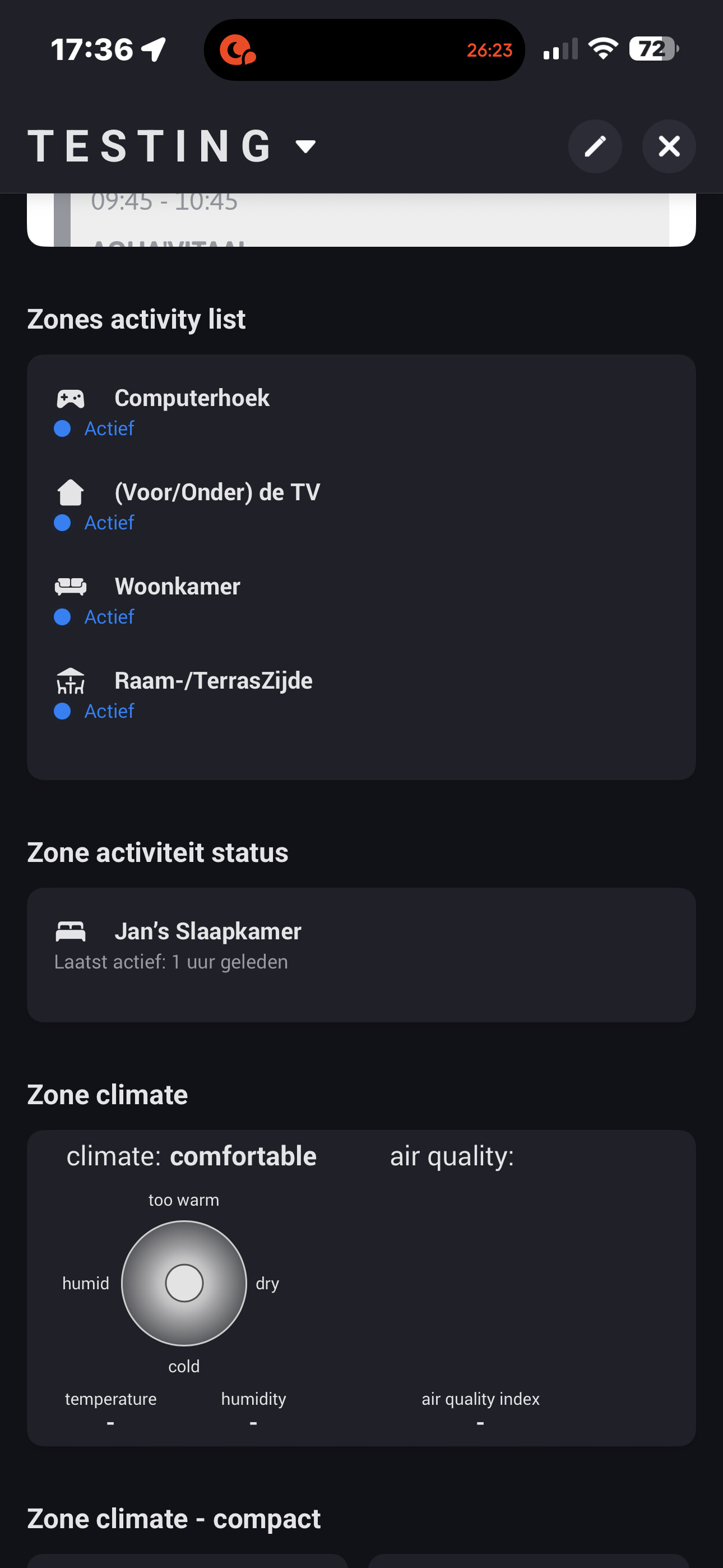

Hi! I Love your app ! Thank you very much ! And I’m just testing your dashboards.
Would it be possible to add a feature/option to only show the main zone or subzone and not both in the activity list ? Because I have a Main Zone “woonkamer”with a subzone “Computerhoek”and within that subzone also the 2 subzones “Raam-Terraszijde” and “Patchkasten”. Now at least 3 of them are shown in the activity list when for example I move, (an I’m detect by the motion sensor in my gaming chair on the “Raamzijde” of my “ComputerHoek” in my “woonkamer”. Please. (I set my (top) zone setting im this activity list on Home = “Thuis”as the zone to watch by/in the list.
Second : Would it be possible to ad a list of (sub)zones to exclude from the activity list please.
3 of the 4 zones in my activity lists in the following screenshot are from me sitting in my gaming chair an my shelly Bluetooth motion sensor in the “woonkamer→ComputerHoek→Raam-Terraszijde”
Can this be somehow avoided and just shown one of these 3 zones instead of all of them ??
