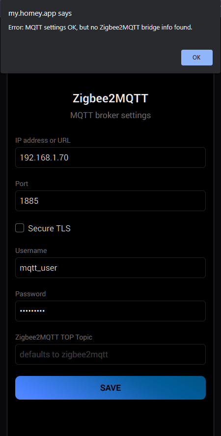

Not sure if you already found the solution for the error message “Error: MQTT settings OK, but no Zigbee2MQTT bridge info found”. I got this error message when I first tred to connect the bridge from Homey. The root cause where insufficient permissions on the mosquitto MQTT broker.
In particular, I had to grant permissions also to the sub-topic. i.e. topic/# the “#” is for the sub-topics.
So, everything works fine. Many thanks to everyone who is involved to make Zigbee2MQTT!!
