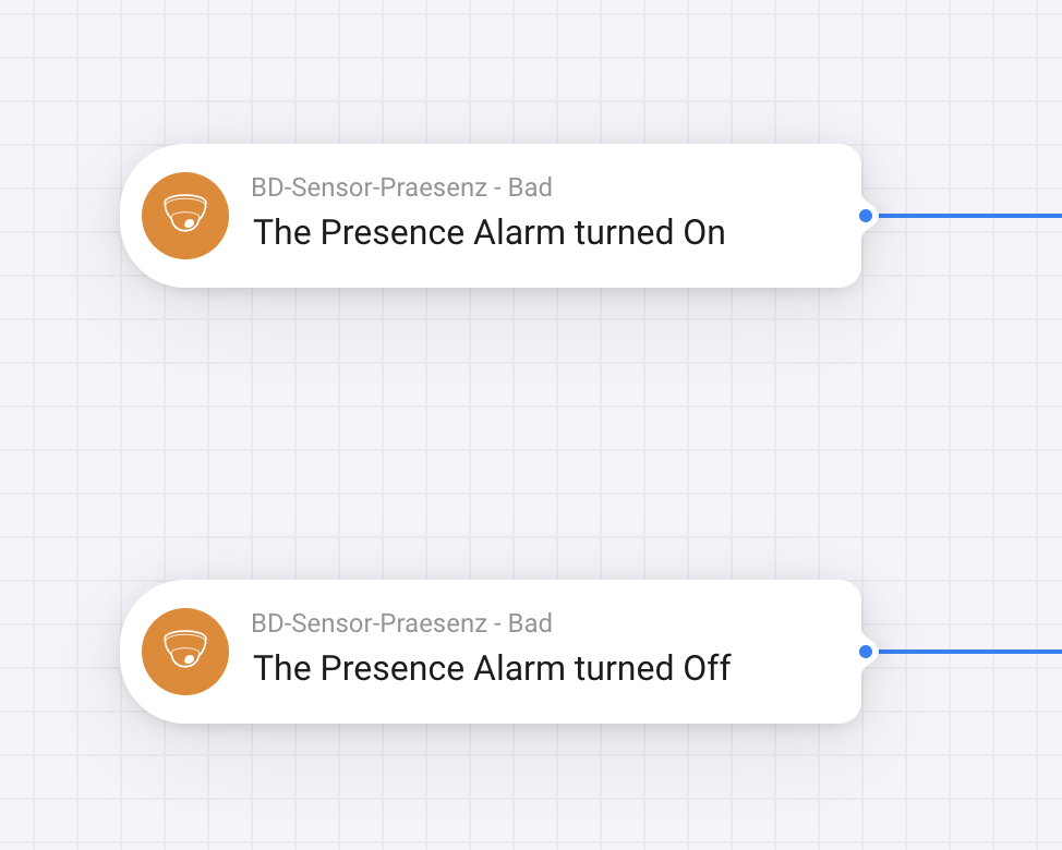

I just moved all my devices from Homey Pro back to Z2M, as the Zigbee implementation of Homey is missing a lot features (groups, bindings, proper reporting, support of devices etc) and used this App to get all my Zigbee devices to Homey. Everything worked very well and almost everything is working. However, I have one small issue with a presence sensor. It was added to Homey without any issues and also recognises the motion alarm - I can see the motion set to yes, when it detects motion. However when trying to use said motion detection in a flow. It does not work. :thinking:
I might have an idea:
Looking at the sensor in my devices it uses the word “motion” and in advances flows it uses the word “presence”, so I think there might be an incorrect mapping?
Or am I just stupid and use the flow cards incorrectly?
The Test buttons work for my flow, so I think the start card just doesn’t get triggered.
I have the same. Weird
I checked the thread again and it seems to have worked before. Just the Zone activation is not possible. But Flows have worked before. So I guess this is a bug?!?
Maybe. Will check. I hope it isnt caused by the latest Homey firmware release…
Edit: I checked the code for triggering alarm_motion.presence and alarm_motion.occupancy, and all looks good. In fact I havent changed that code in a long time. So that the flow cards don’t trigger anymore does seem related to a Homey firmware update. I have found that Homey has several issues with sub-capabilities. I already informed Athom about it. But I guess it is a matter of priorities.
