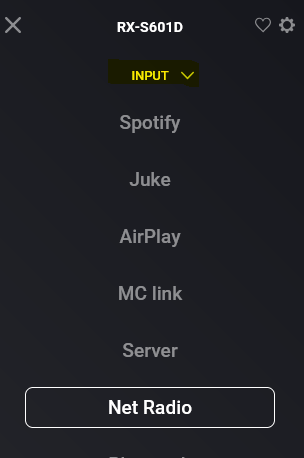

New to Homey and so happy to find this app!
Can you add Amazon Music and Alexa to this of inputs?
Thanks,
John
Can you please open the repair mode for the device and send me the device features (as PM)? Thanks.
New test version 1.1.14:
  • Added AmazonMusic and Alexa to MusicCast Input list.
@John_Mag FYI, you can install the test version using the link above and check if the new entries in input list are working as expected.
Works great. Thank you for such a quick response.
