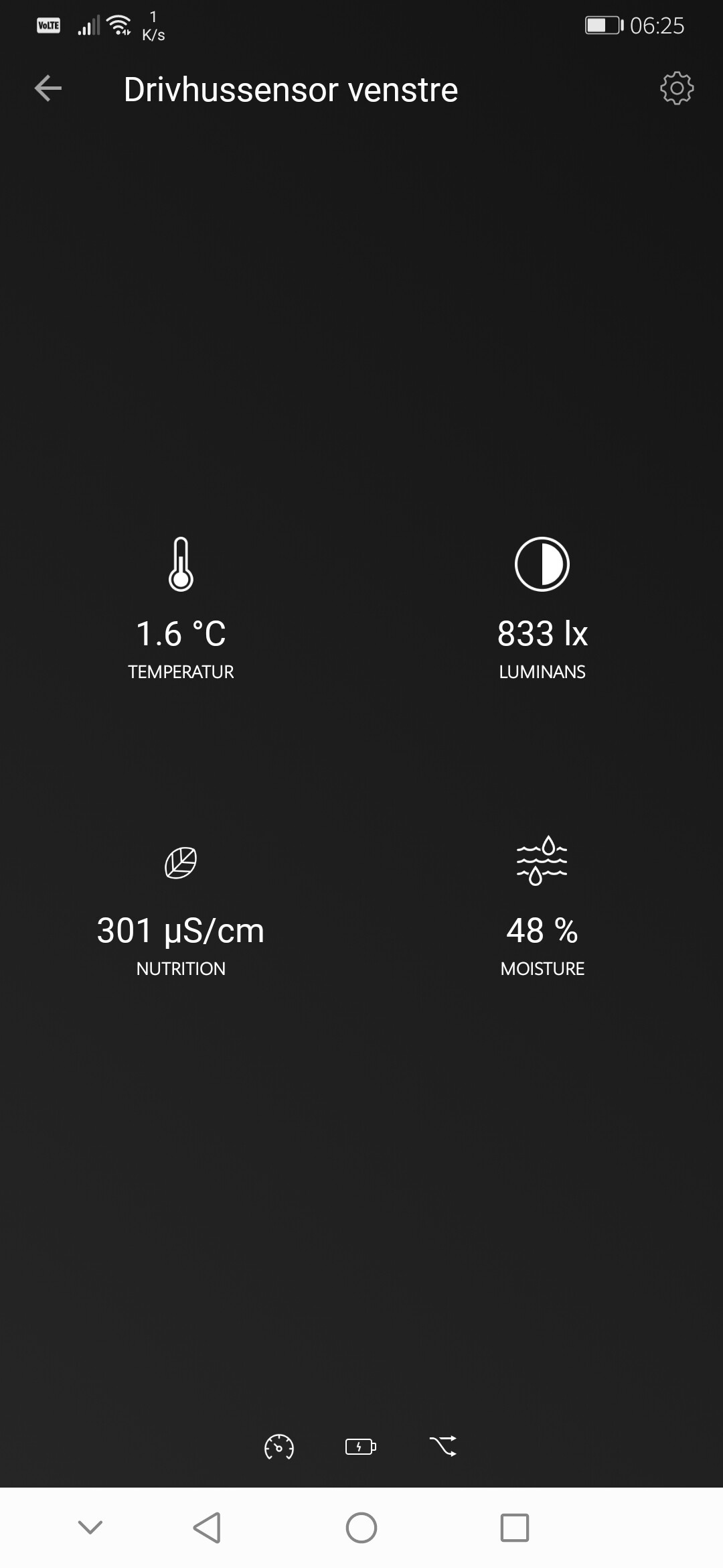

I have 2 mi flora sensors, i don’t think they report the right values.
I placed the in same soil just next to each other, and the values is different. Temperature is on the one the same.
Any idea how to fix?
Have you compared the values when the sticks are connected to the flower app?
Not sure if it will help, but actually something related to the Luminance has been fixed in the most recent version
