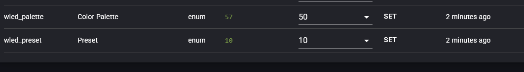

New release 1.0.3:
-Have fixed Preset, Effect, Palette in flows
-Updated Source URL to to the correct repo
Check now if it works with version 1.0.3.
Thanks a lot, will check.
„ Maybe you have an older wled version? Right now 0.15.0 is latest.” - do you mean app or wled firmware? Thx. J
