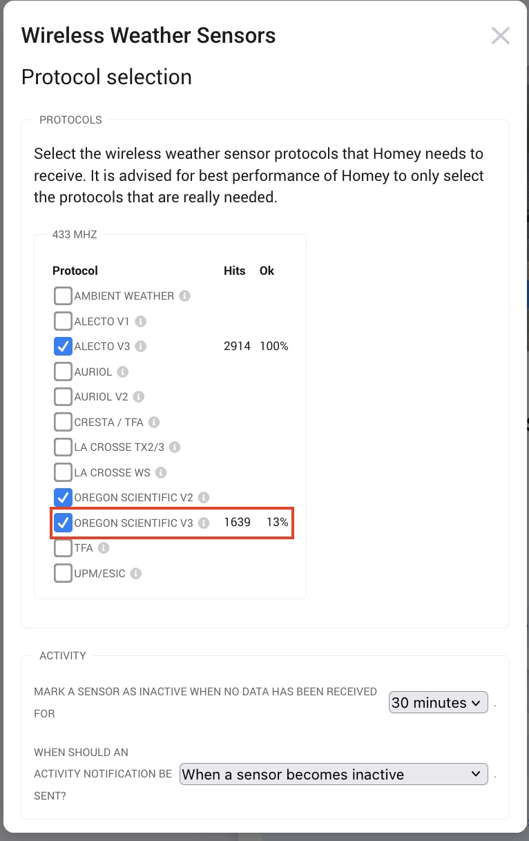

Does anyone know what the “OK” number is in the apps configure page? I’m guessing that is has to do with how well Homey receives the signal from sensors of the specific protocol…but how does it work? If the number is below 100% are the signals incomplete, scrambled or what?
I have had major issues with this app for weeks now and I’m putting hours after hours of work trying to figure out what’s wrong. Since there is no support at all for this app any more there is not much one can do but to struggle in the dark.
I deleted all my sensors from Homey and the app and Homey was stable for more than 48 hours (which it has not been for many weeks) and are now starting from scratch. I first powered all my 18 sensors but did not include them in Homey. I then installed the app and monitored the configure page. I have sensors working with two of the protocols: Alecto V3 and Oregon scientific V3. The first one has 100% OK but the Oregon has low OK, 13% when I took this screenshot:
(Ignore the Oregon V2…I have unticked that after the screenshot)
Why is this number so low? Those sensors are on an outdoor weather station that is located about 3-4 meters away from Homey with just wood and roof tiles in the way.
My next step is to unpower all sensors (except the weather station) and start to include one sensor at the time to see if Homey starts acting up again. If it does I know that this app is causing major issues with Homey and I can not use it anymore.
