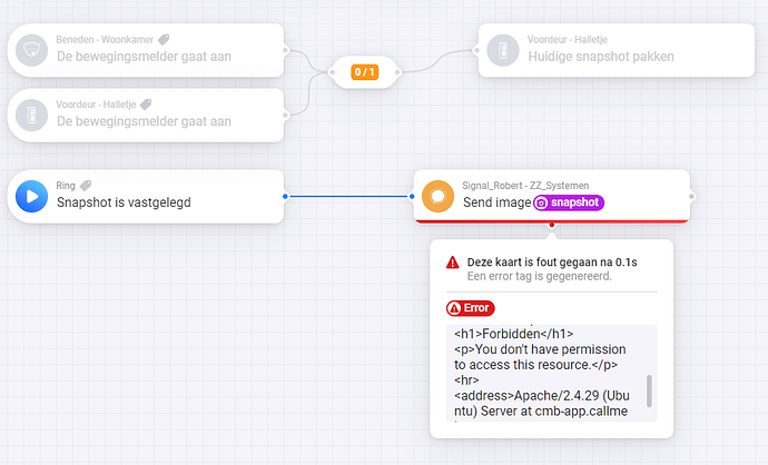

Sending snapshots to FB is not working in HP 2023. native Homey notifications sends the snaphot correctly.
Schermafbeelding 2023-06-17 123939
That’s an homey pro issue. They are looking into it, but don’t seem to prioritize it. I expected it to be fixed in rc118 as the changelog said it d be fixed, but it still doesn’t won’t.
Hello
I already reported the problem with the images and error 403 to Athom about cca. 6 weeks, unfortunately still no solution
homey23 send the images as xxx.bin file so this error message occurs, if you send the image by e-mail sender it is also an xyz.bin but if you rename it it is the image.
So the only problem is the incorrect file extension.
it works for push messages
Let’s hope Athom solves this problem

Hey i try to send a image with callmebot and Signal. I get a error message from the flowcard. The preview image is available
