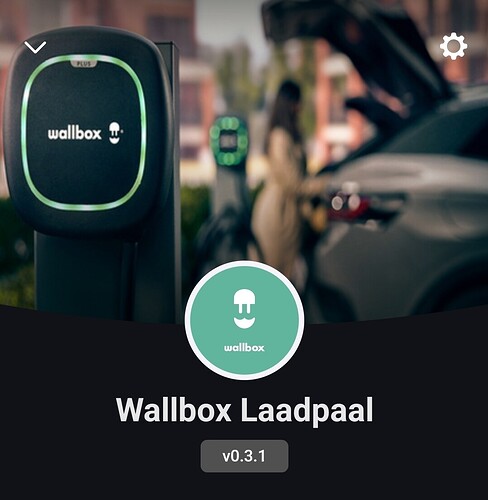

Recently I installed the #Wallbox app and it works perfect. The only question I have is why its not recognised as an EV-charger on the “energy page”. When I use a power socket (and selected as EV-Charger) I see a car in a garage. With the wallbox I only see a closed garage door. Does anyone know why?
Witch version you installed?
This one. But I see you have another one!?
Yes you must install the test version
