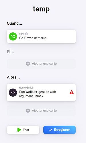

I just tried your script but i have some issues.
I’m not very familiar with homeyscript and maybe i did something wrong. Can you help me?
When i try to unlock
I have an error
After some tests it works better, but i only hear Homey speaking and don’t see anything changing for my wallbox (android app).
Can you confirm that my 3 first lines are right (of course the values are just for example):
Capture5
Sry for the late response.. I never get notifications for some reason..
try removing all the “<” and “>” they should not be there.
Thx for answering.
I finally made it :slight_smile:
Atually the problem was about the ID of the charger. As someone said above, you have to take the serial number in the wallbox app and not the id!
