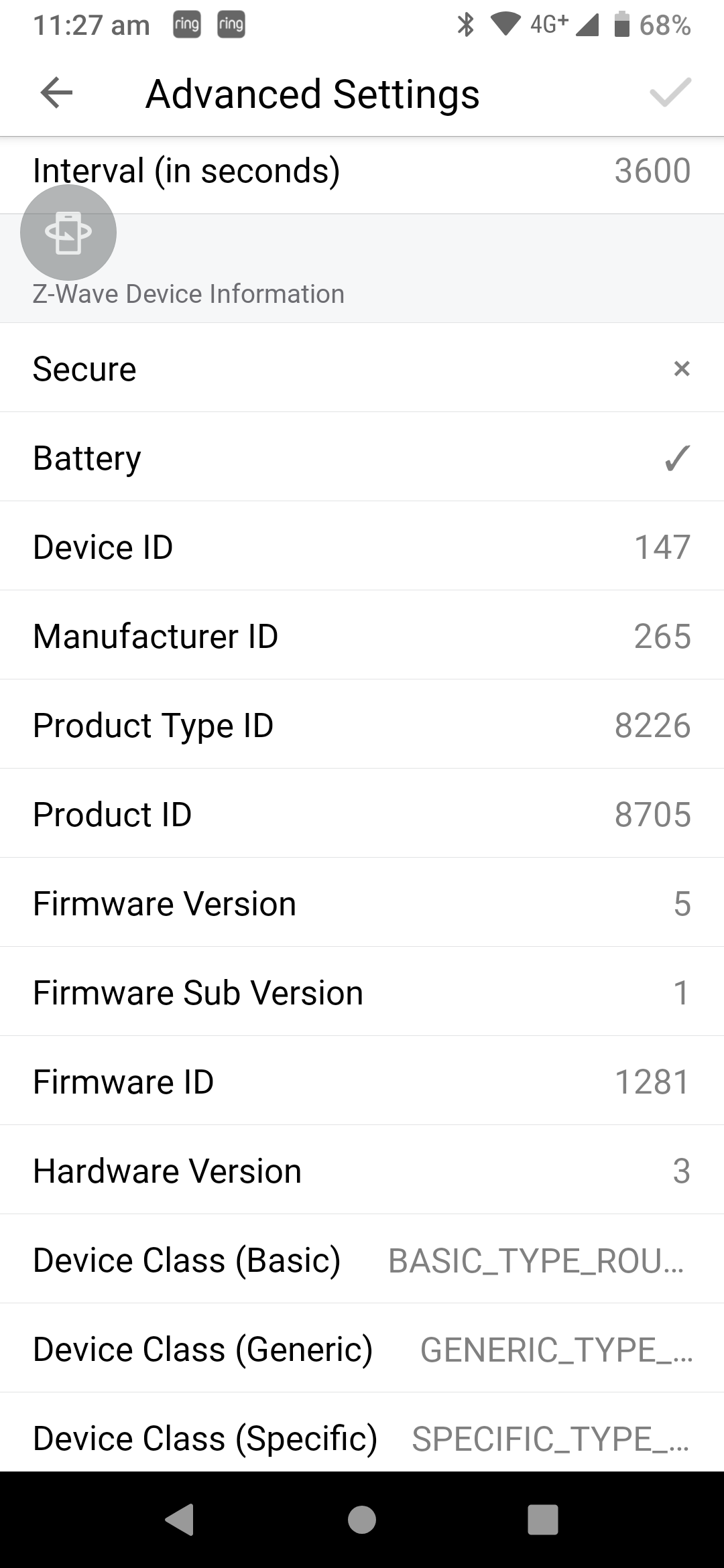

I have the following devices:
Multisensor 4 in 1 ZD 2201BR-5
Recessed door sensor ZD 2105BR-5
If I capture the specs, would it be possible to add these?
Robert
These are the Z-Wave specs:
ZD2201
ZD2105
Appreciate if you can help.
Robert

Thanks for the screenshots.I need that to add them :slight_smile:
Once I have a test version working I’ll let you know
Thanks so much
New app update (test: 2.6.0 ):
  • NEW: ADD ZD2201 and ZD2105
@OzFrog can you test if this test version works for you? :smiley:
