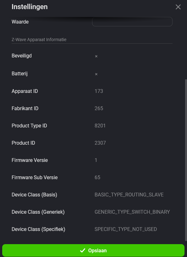

I’'m trying to install my Vision - ZM1602 DC/AC Power Siren with the Vision Homey app. After installing the apparatus is only installable as “Simple - Z-Wave apparatus” not as a Vision apparatus. By installing the Siren is < 1 meter from Homey. I hope you can help me with this. Thanks
Hey @Jan_van_Setten ,
When it’s added as a Simple - Zwave device can you share an screenshot of the device settings?
it might be that it has a different ID which is not in the app yet.
A screenshot of the device settings:
New app update (test: 2.3.5 ):
  • FIX: ZM1602 add productid 2307
@Jan_van_Setten Install this app version. Delete the generic Zwave device and try to add it via Vision Security.
Martijn, this is working, thanks for the fast reaction ! :wink:
