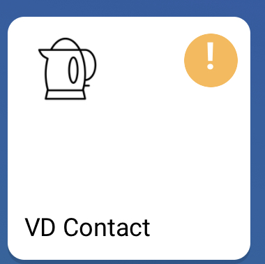

If you are only using the VD to show a status. And you don’t have the necessity to switch the VD manually only through flows. So, why you don’t use a Virtual Sensor instead a VD switch?
Yes I know, :wink: I figured as soon as I posted. I deleted my post directly.
But it takes some time.
yes, this an option too, if the sensor have the option to turn the icon to illuminate or grey will be best.
An example of a virtual contact sensor.
Contact Alarm = true
Contact Alarm = false
Thank you! That’s a very innovative to solution to use the door open/close alarm aka contact alarm :smile: with a slow cooker svg will it perfect :grinning:
