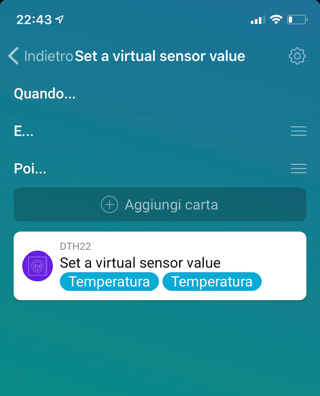

Hello… I’ve a Sonoff with DHT22 Sensor for measure temperature and umidity in the external home.
It send the value in a raspberry broker mqtt and the value every 30 second and the value in the broker is the same:
21:34:43 MQT: tele/sonoff/SENSOR = {“Time”:“2019-09-09T21:34:43”,“SI7021”:{“Temperature”:25.5,“Humidity”:40.3},“TempUnit”:“C”}
I’ve create a virtual device for Temp and Humidity. I’ve install MQTT Client in Homey and i want to read the mqtt value of the sensor and set it in the VD.
I’ve crate a flow with WHEN “message received from topic tele/sonoff/SENSOR” THAN “set a virtual sensor value” Temperature Temperature.
But it doesn’t work for me…
Can you help me, please?
Thanks
You must use:
set a virtual sensor value:
measure_temperature (temperatura) (tag)

Sorry, I think I don’t understand. Don’t work.
I’ve set this:
And this is the log of mqtt client:
Thank you so mutch
Thank you Edoardo, before the previously topic i’ve Test this configuration, but don’t work for me.
This is my setting, identically your.
In the second setting, i’ve use The tag “temperatura” in the DHT22 line.
I don’t understand why don’t work for me.
Thanks for your help.
What happens if you test the flow?

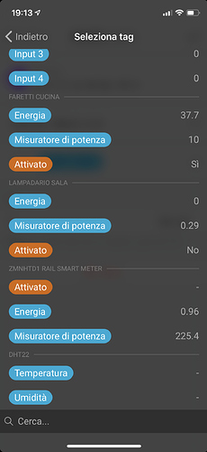

Edit: You must enter in the virtual thermostat to see the value.
Edit 2: your device DHT22 is not reporting temperature values, is your virtual device. You must select a real device reporting temperature (your sonoff device tag).
Edit 3: I read you use a mqqt topic. Try using better logic:
Flow 1
when: receive topic triggers >>Then: set number variable (create a variable for this value)
Flow 2
When: a variable changed >> Then: set a virtual sensor value, measure_temperature and the tag of better logic you set before.

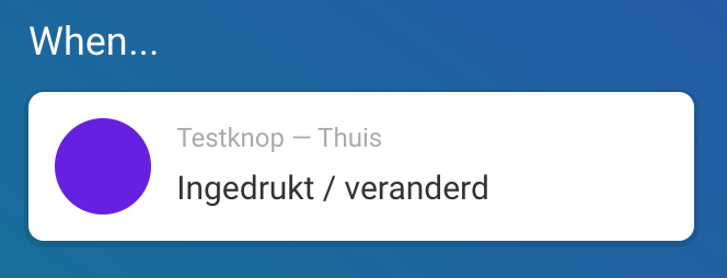

Hi all! New to the forum and just starting with Homey.
Can some-one explain how to trigger a flow when pressing a virtual button? I have searched the forum and the documentation, however cannot find a solution for that?
Using the “Virtuele Apparaten” experiment;
Using the “Virtual Devices” app:
Thanks! That works :slight_smile:
