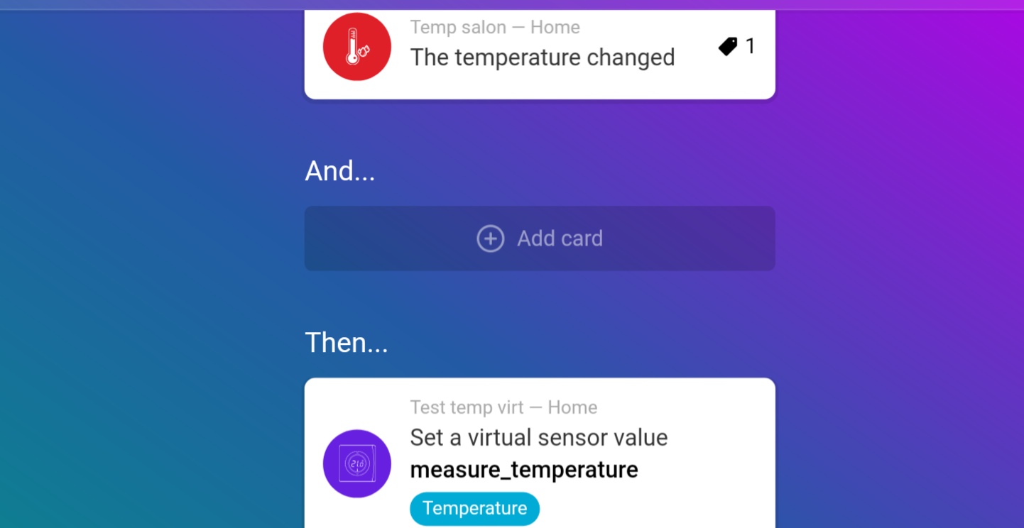

I wanted to learn virtual devices and started with temperature. I have a few temperature meters
-wanted to get the actual room temperature in a Thermostat.–
I have been reading this over and over
But im just overwhelmed, did not found more precisions in this post.
I created a vd with temperature meter type
I went in flows
In “when” i put edit: my actual meter/ temperature changed
In “then” i put “set a virtual value”
First card measure_temperature
Second card my temp meter actual temp
Feels like a puzzle where i have to find all kind of missing parts :cry:
Thanks but you just added a new info to the puzzle,
@RoyWissenburg is this the “when” card to use or just an example showing what a label is?
So the “when” is not the virtual device but a logic??
So i took the logic “when a variable changed” / select an item ,but them i got an empty list “no results”
A step by step would be really helpfull, this guessing game is tiresome
– the actual room temperature in a Thermostat.–
Like in
Thanks, but deeper in details, less conceptual
Can you just tell me if this is correct?
I went in flows
In “when” i put edit: my actual meter / temperature changed with tag temperature
In “then” / virtual device / i put “set a virtual value”
First tag: measure_temperature
Second tag: my temp meter “temperature”
Thanks, got the logic
Somehow it doesnt work, no update of my vd value
