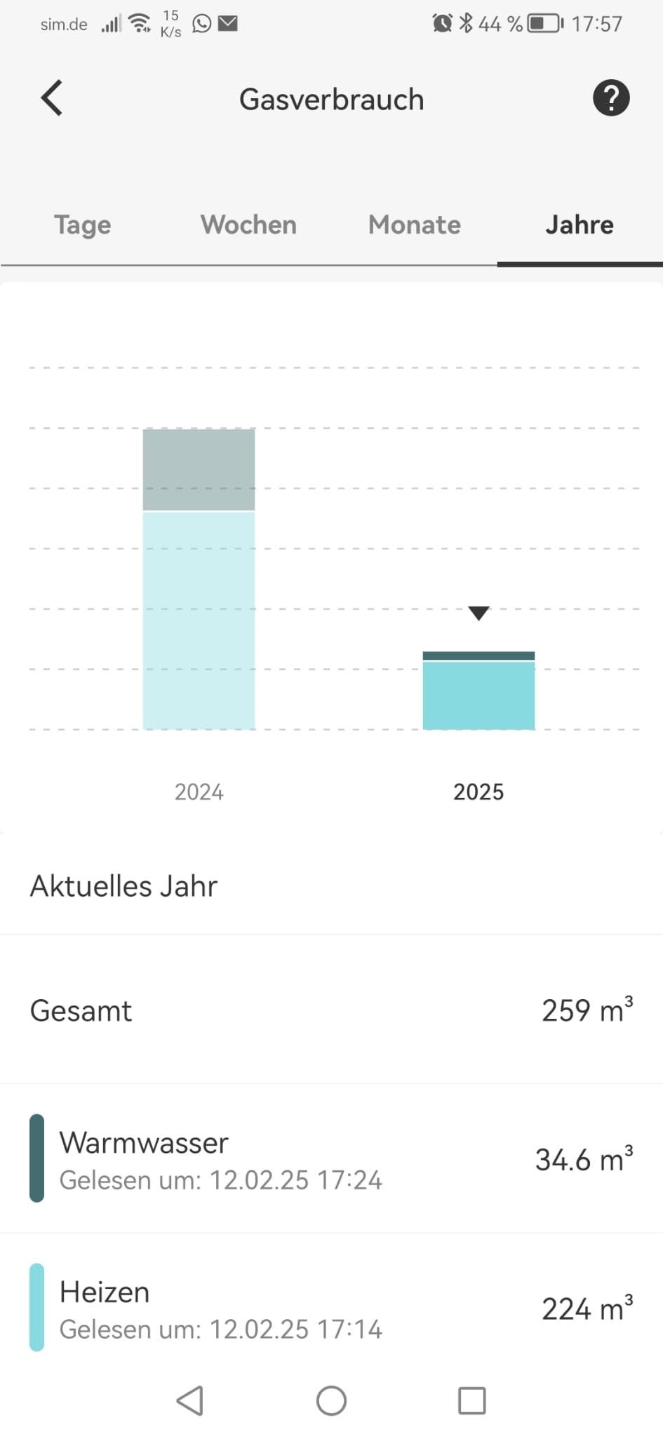

Something is still wrong with the gas meter.
According to the gas meter in the basement, we have used around 216m³ since 1/1/25.
In Vicare it is 259m³, in the homey app it is 489m³.
I deleted the homey app on 1/1/25 specifically so that I could start from “0”.
Also the sum of 31.9 + 248.1= 280.00 is somehow not correct.
or am I making a mistake in my thinking?
Best regards :wink:
Hmm. I have to dig deeper in this. Don’t have a direct answer… The calculation is quite complex internally because the api does not directly provide it.

It is still my personal conviction the Viessmann gas consumption is only a “guestimation”. At best. And therefor I do not consider it anylonger.
I for myself, do not believe at all in their re-partition of consumed gas volumes between heating and sanitary hot water production. As an example: when I have over production on my solar, a triac is heating up an electrical hot water boiler. The hot water is fed by a sanitary hot water pump into the Viessmann heater. The temperature setpoint of the triac controlled electrical heater is at 50°C, where the SWW setpoint in my Viessmann is at a lower 45°C. On days where the hot water tank is heated to 50°C by solar, I still can see a sanitary hot water consumption in my Viessmann (Vicare).
In the electrical diagrams of my Viessmann Vitodens-222W , there is no mention of any (gas) flow meter. Hence, it must be a guestimation based on gas pressure, burner modulation and (maybe) boiler / outside temperature(s).
Hello, You could be right. :wink:
For me, Vicare is just an estimate.
I only look there if the consumption is out of the standard.
My “gas meter” with a window sensor is more accurate than vicare.
I was just surprised that the data in vicare and the homey app differ so much. The source (API) is the same.
But there may be differences in the API for different models of burners.
