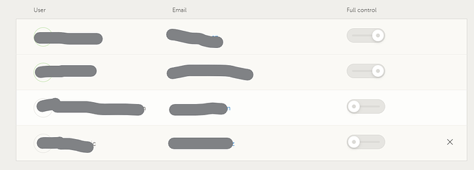

Ah ok. I dont think I am using MFA. I log with email and password to my VRM app. And yes I do see solar forecast. I saw already consumption forecast is aproachin in DESS. But this I do not see yet.
Maybe because I do not have Full control?

I was granted the full control of Cerbo but my homey VRM device still has no data :frowning: So that was not the problem.

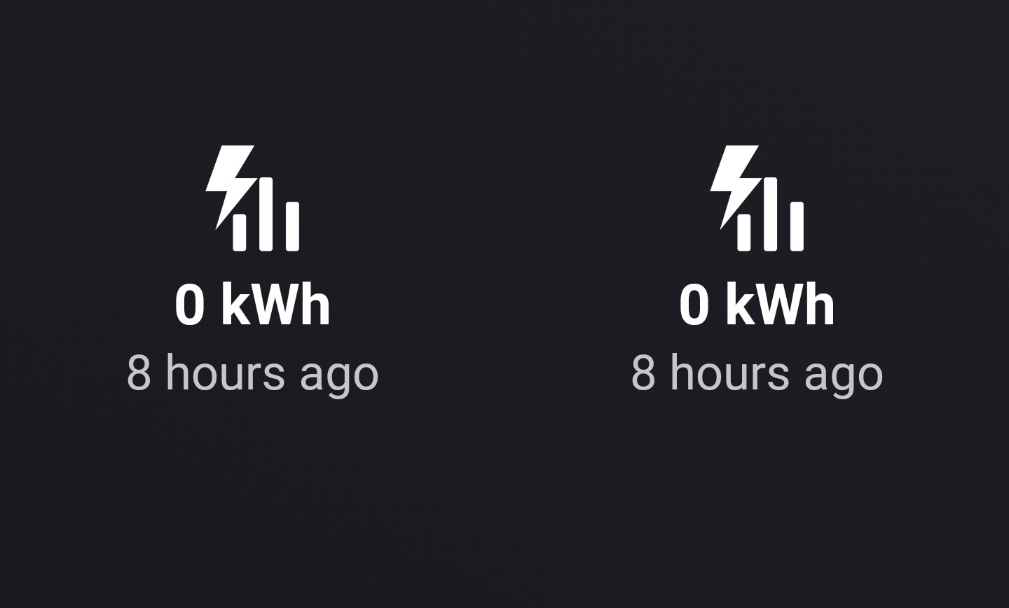

After adding the VRM device in Homey it doesnt fetch any values, shows 0 all the time for VRM forecast data.
Added a diagnostic package: 932f574f-7755-43a3-bd4a-08668cba1215.
Tried adding the VRM device using Windows PC and using Android app - same result.
/Kaj
