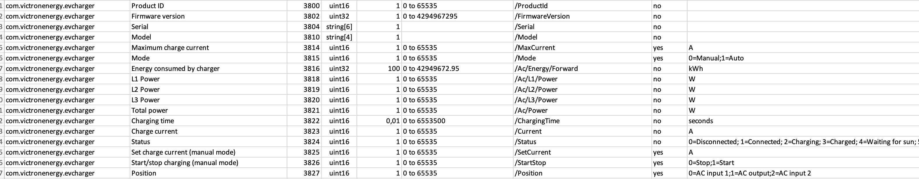

Hi @Richard_B do you plan any possibilities to manage EV charger via Cerbo? Planning to install EV charger but deciding whether Victron charger or other brand working with Homey.

Did a quick check and these are the modbus registries available. Guess it is possible to do a separate device type for the ev charger. The only challenge is lack of access for testing, someone else would need to install the app via CLI and do testing.
Iâll push the battery change to a test version, the change I mentioned a few posts above.
