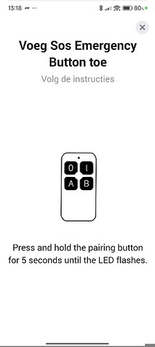

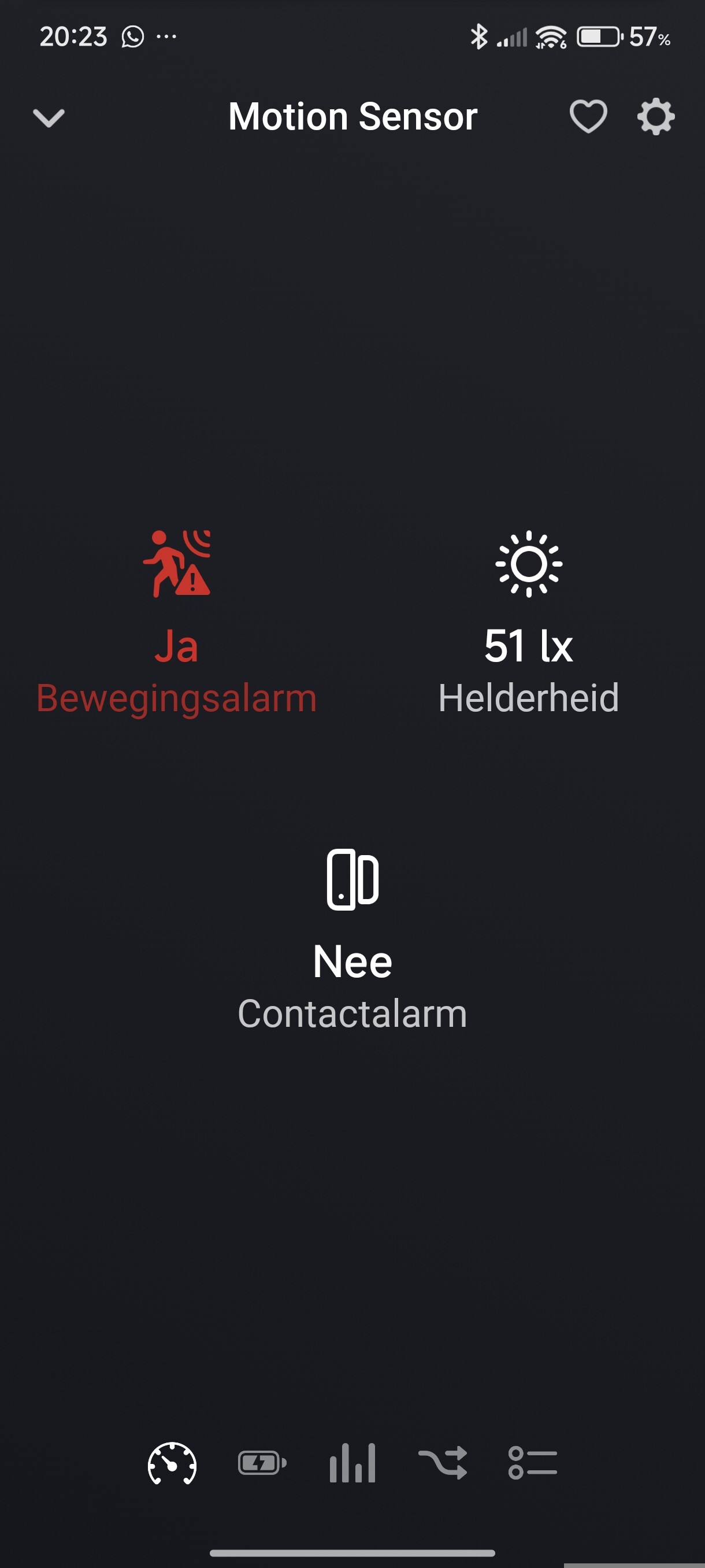

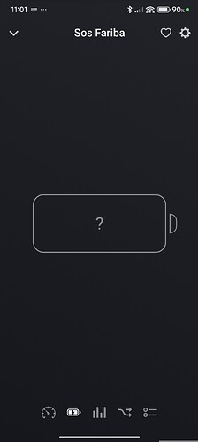

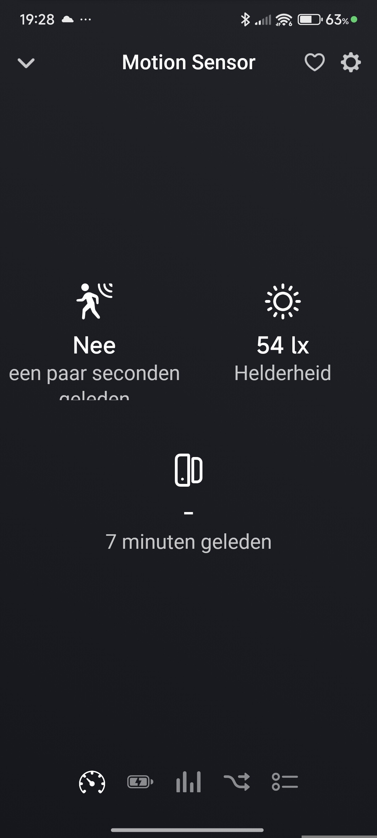

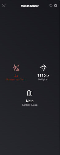

Hi Dylan Good evening,
I tested my SOS Button :radio_button: again but not triggering the Homey and no Flow activation. Battery readings are okay :+1:t2:

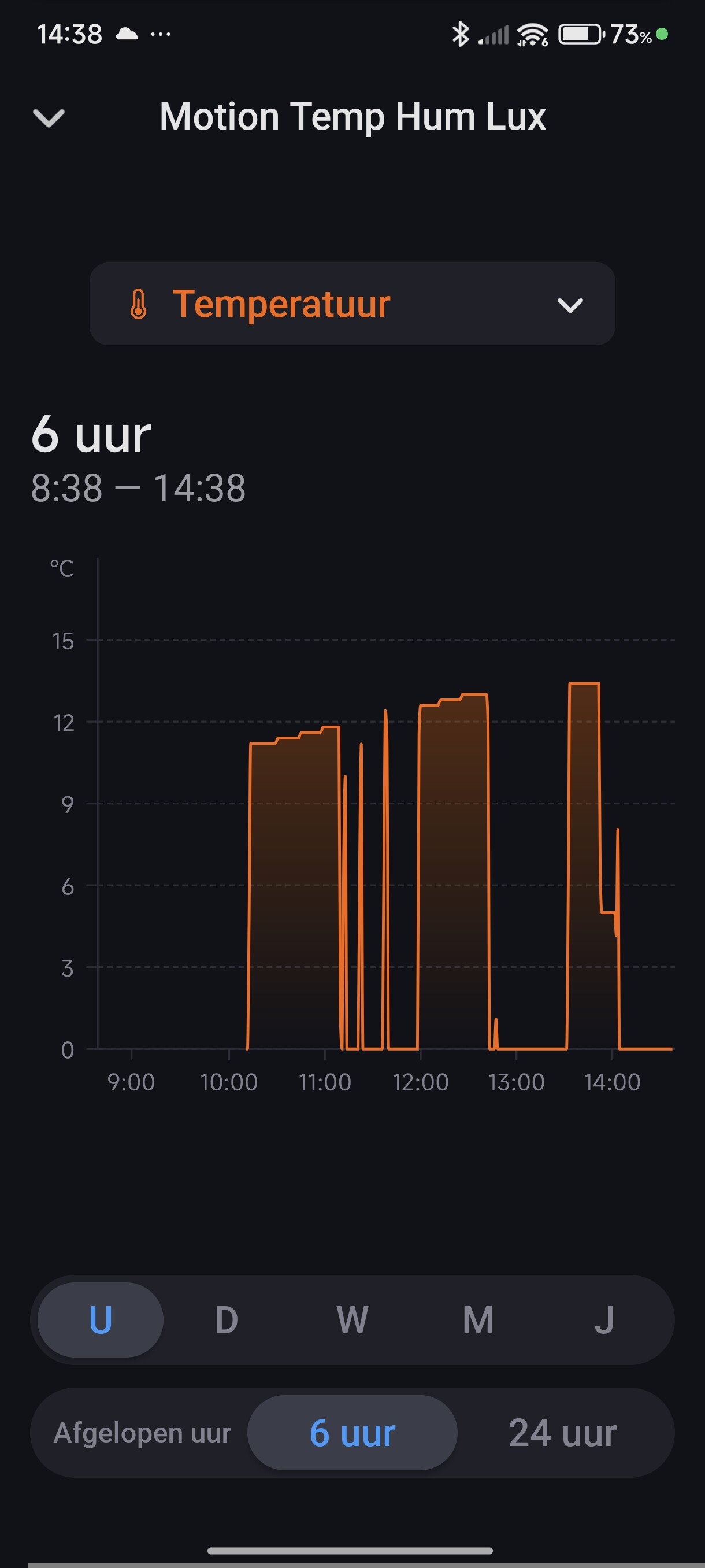

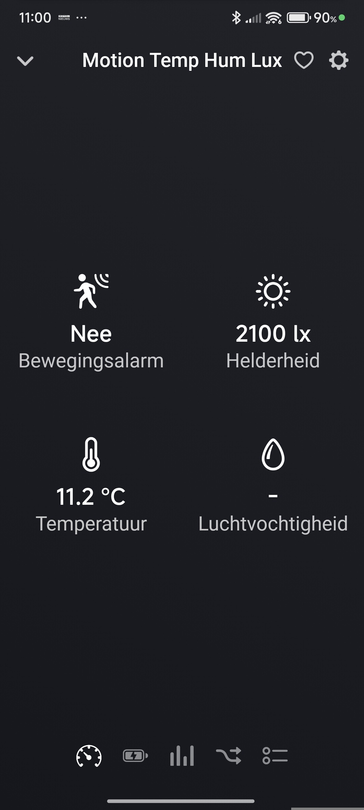

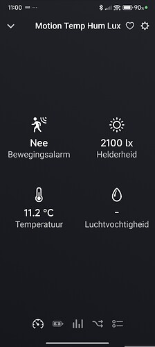

Multisensor is only showing Motion and Luminance, no Humidity and Temperature. Battery readings are okay :+1:t2:
See screenshots
Diagnostic report: 088dec1a-1463-4a05-9de5-8df1b10b41e6
Thanks for all your effort again and good luck.
Best regards Peter.

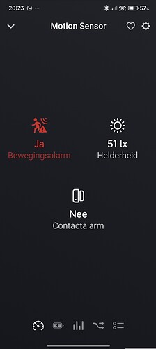

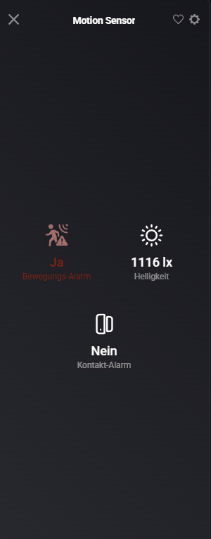

Not sure if the last 3 data points are too much or just not working. It’s not a contact sensor.
ZG-204ZM is also working
It also shows contact alarm, which is not needed.

Hi Dylan Good evening, I still missing the Temperature and Humidity on the Multisensor.

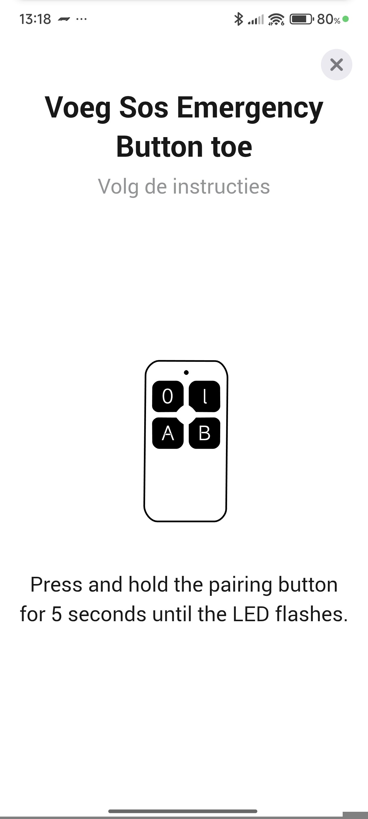

Great news I have fixed the issue with tuya implementation.
Hi Dylan Good morning,
I’ve installed version 5.5.94 still nothing happens with SOS button and I’ve got Temperature and Humidity in the Multisensor
No response on SOS button and no battery readings anymore and Multisensor no Humidity readings.
Diagnostic code: abb7f0eb-262b-454f-8bf8-8f562c6a7cec
Thanks and good luck, regards Peter.
Hi Peter,
Thank you for the diagnostic report! I’ve identified and fixed both issues in v5.5.102 (just published):
:wrench: Fixes Applied:
1. Motion Sensor / Multisensor - No Humidity Reading
  • Root cause: Your motion sensor doesn’t have temperature/humidity clusters, but the driver was trying to read them anyway (causing timeouts)
  • Fix: v5.5.102 now detects available clusters dynamically BEFORE initialization
  • Result: No more timeouts, only available sensors are queried
2. SOS Button - No Response + No Battery
  • Root cause: Sleepy device, battery read was timing out
  • Fix: Added 3 fallback strategies for battery reading:
    1. Standard batteryPercentageRemaining
    2. batteryVoltage with conversion
    3. Read all battery attributes
  • Result: Better battery reporting after button press
:high_voltage: Action Required:
  1. Update app to v5.5.102 (Homey App Store or Settings > Apps > Universal Tuya Zigbee > Update)
  2. SOS Button: Press the button once to wake it up and trigger battery read
  3. Multisensor: If humidity still missing after update, the device hardware may not support it
Let me know if issues persist after the update!
Best regards,
Dylan

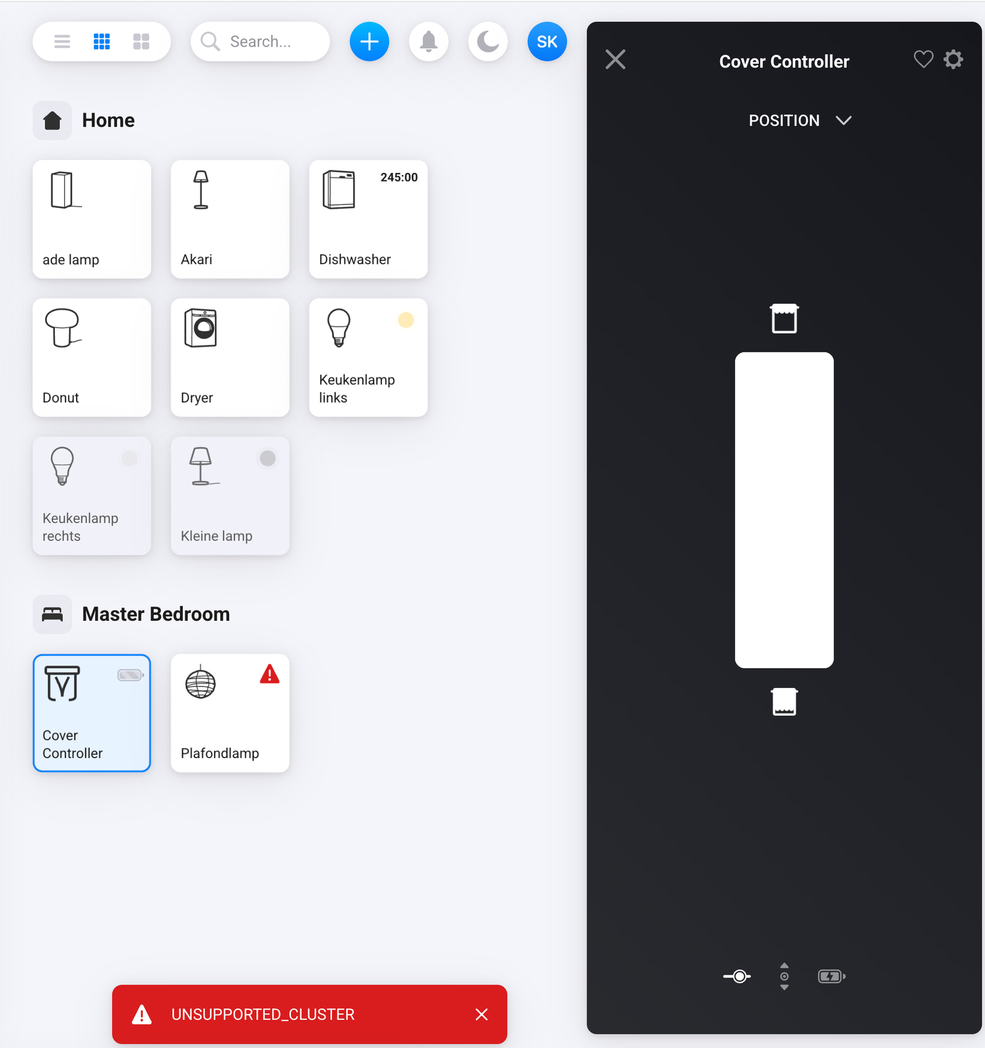

Thanks for working on it! I still receive the Unsupported_Cluster message. Or missing capability listener for Dim or Tilt. Lmk if you need more info.
Manufactor ID
TZE200_icka1clh
Product ID
TS0601
Receive When Idle
Device Type
enddevice
Device ID
7c:c6:b6:ff:fe:2b:cd:c2
Hi Dylan thanks for your update

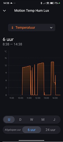

Multisensor temperature now, no humidity reading okay in version 4.1.1 I had all correct readings from this device, SOS button still nothing there and a not corresponding pictogram anymore see screenshots.
Diagnostic code: 00973ab8-e01d-414b-a396-b71a1abf4c4a
Good luck again,
Regards Peter.
Multisensor is okay now, got all readings :+1:t2:
You’ve don a great job :wink:
Dylan temperature from Multisensor is fluctuating all the time actual outside temperature is about 14 degrees at the moment.
Best regards Peter.
Also not detecting movement anymore :slightly_frowning_face:
And actual Humidity is now about 89% but reading from Multisensor is only 50%
Motion is working at the moment,:face_holding_back_tears:
Since update 5.5.107 the Temperature & Humidity are also stable in reading so the Motion sensor seems to be okay now thank you very much for that you really doing a good job :+1:
The SOS button Icon is okay now only still no battery reading and still not triggering the flow.
Good luck and have a nice evening,
Best regards Peter.
Might be solved . P’ease check
Hi Dylan, SOS button not triggering the flow or showing response in the app and still no battery reading.
Diagnostic code; 962111b2-e894-4db6-9ba3-02845ae07d9b
Good luck :crossed_fingers:t2:
Regards Peter.
