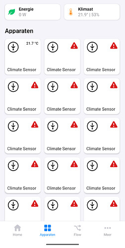

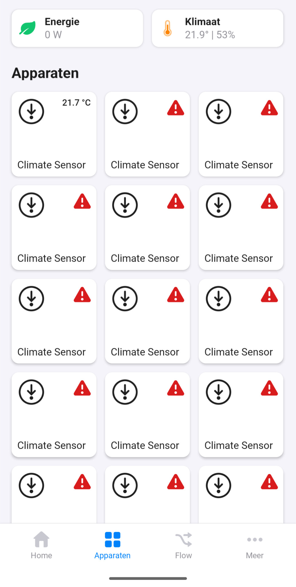

My temperature sensor (TZ3000_akqdg6g7) is now adding succesfully and showing correct information :partying_face:
It’s just added as 22 devices at once :joy:

  1. Phantom Device Fix (ROOT CAUSE)
  • Removed \devices\ arrays from ALL 35 drivers
  • These arrays were causing Homey to create 1 sub-device per entry
  • Your climate_sensor had 54 entries → 54 phantom devices!

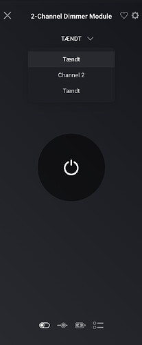

For this 2 channel dimmer (_TZ3000_7ysdnebc TS1101) it doesn’t seem to pick up that it has two channels but only 1. The selector is also funky showing only “On | Channel 2 | On” (On == tændt) in my language. See attached image. The choosing the first “On” makes it control the first channel. The two other selections doesn’t do much.
