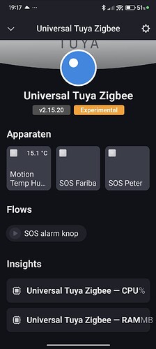

Hi Dylan I admire your drive to get it solved :star_struck:
But I wish I could tell you that everything works but unfortunately it’s not.
The HOBEIAN multisensor still don’t show motion even not after deleting and restarting :slightly_frowning_face:
And the SOS button still nothing happens after click the button also not on a 2nd installed SOS button :slightly_frowning_face:
And still no proper icons shown in the app still a little square with nothing in.
Diagnostic code: 5b66b6ed-c26d-41e1-ab3d-be2cb11f695c
Sorry to disappoint you and hopefully you still got the urge to continue :sweat_smile:
Best regards and hopefully a good evening,
Peter.
