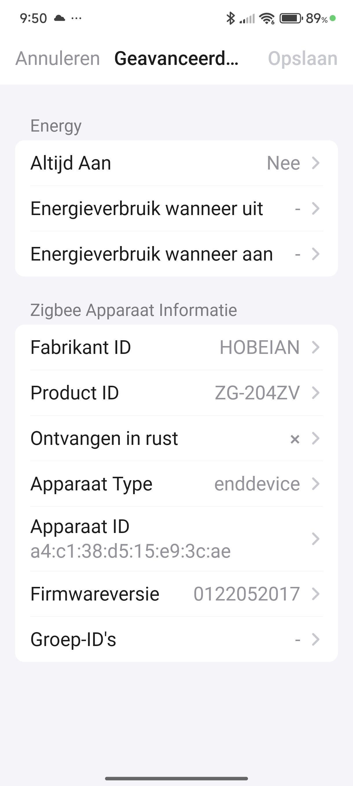

**Device Information**
- Model Number: ZG-204ZV
- Manufacturer: Hobeian
- Device… Type: multi sensor - radar motion, temperature, humidity and illumination
- Purchase link : I just found this on AliExpress:
C$9.07 | Smart ZigBee Pir Motion Sensor Radar Mmwave Temperature and Humidity Sensor Security Burglar Works With Home Assistant
https://a.aliexpress.com/_mrlhbgN
**Current Status**
- [ ] Device is not recognized by Homey
**Zigbee Information (if available)**
- Cluster IDs: (from Zigbee2MQTT or other tools)
- Endpoints: (if multi-gang or complex device)
- Power Source: (battery)
"ids": {
"modelId": "ZG-204ZV",
"manufacturerName": "HOBEIAN"
