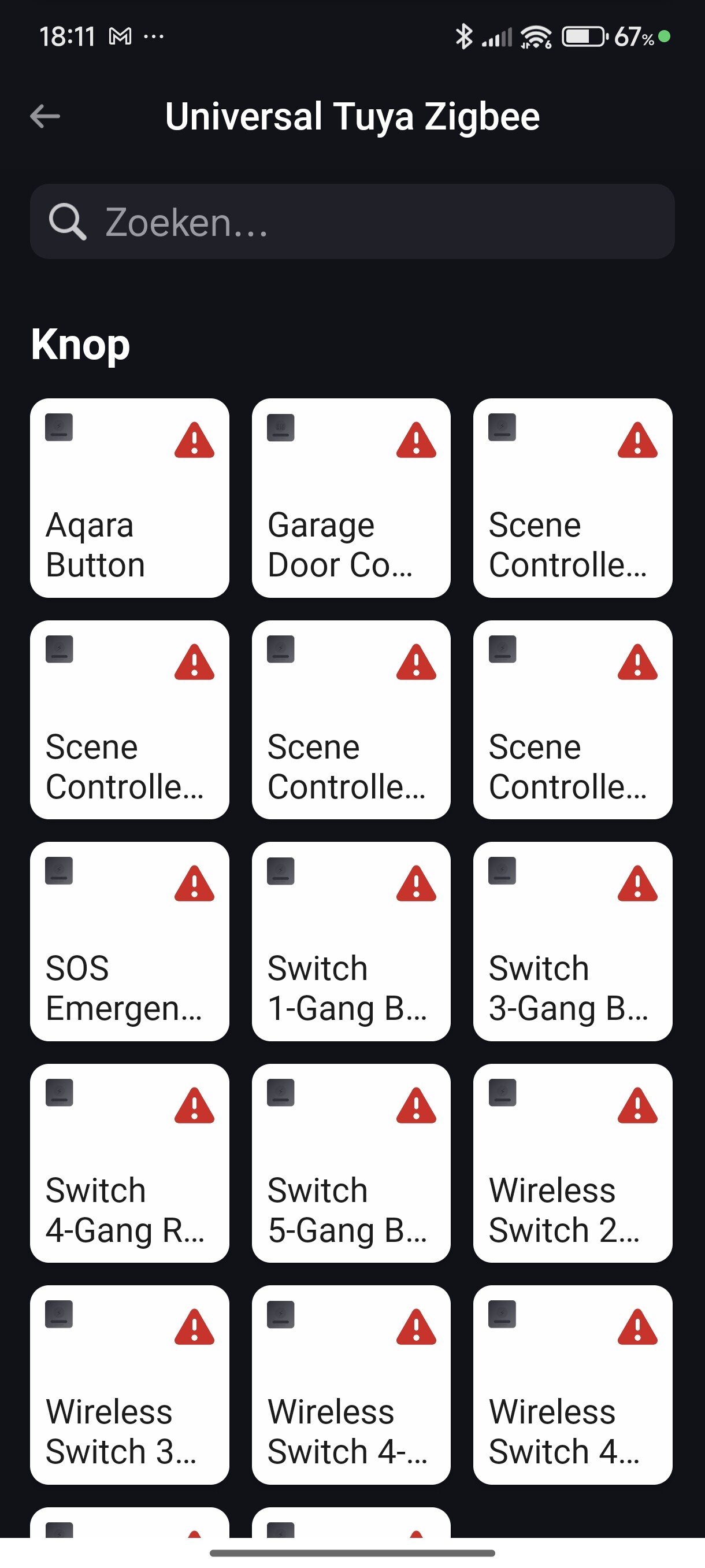

Thanks for this update, Dylan. Unfortunately for me, there are probably <5 devices that don’t have a red error sign on it when I try to add a device. As it is, I’m unable to add anything through this app.

Still the same issue here, all exclamation marks and can’t select them, no reaction when you tap the icon’s.

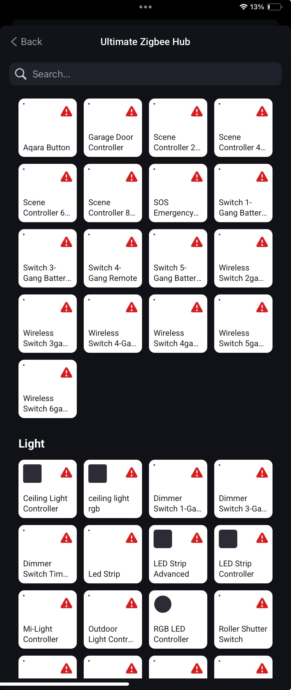

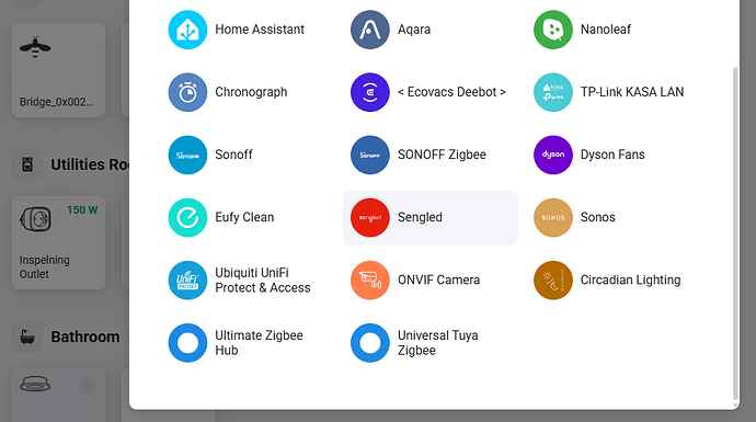

Not sure if this is expected behaviour but the link you provided above takes us to ‘universal tuya zigbee’ app and not ‘Ultimate zigbee hub’ app. So, it installed as another app. I am having the same issue with red exclamation marks with new app too. Maybe others can confirm.
Yes i have changed the name. Because of new app icon.

Hi Dylan, I’ve installed your new Universal Tuya ZigBee app but still nothing selectable and all exclamation marks.

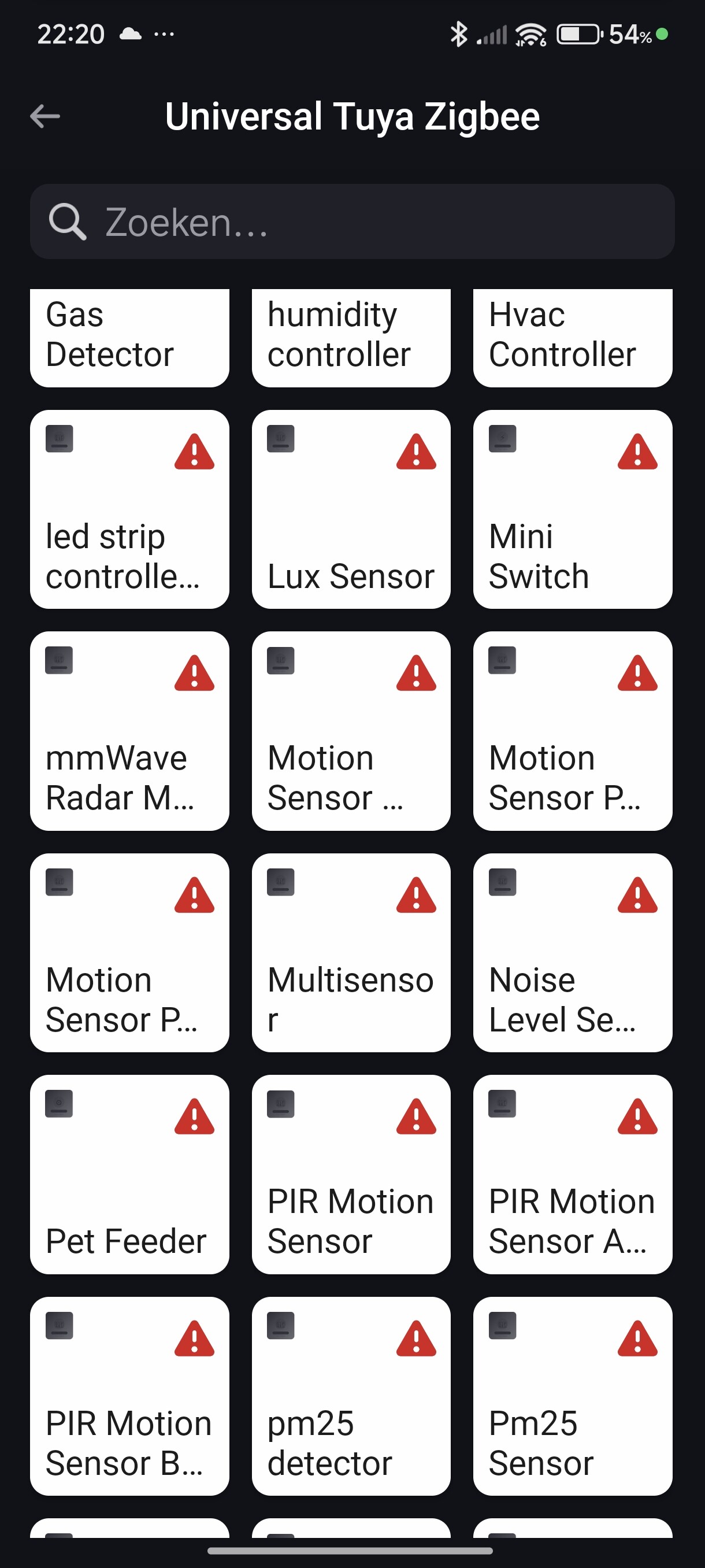

Hi Dylan, still exclamation marks :slightly_frowning_face:
Only this one the Ventilator is selectable.
