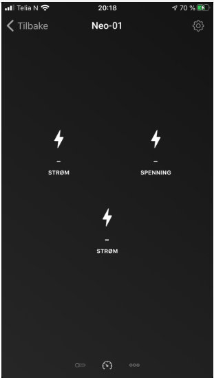

Got a couple of NEO 3600W devices, and found the id and key. They both works in TuyaSmart app, but it’s ‘dead’ in Homey…
What can possible go wrong ? I can ping the ip address of the device.
But generally I don’t like to have access to the device from internet, so to isolate it, maybe it’s better to flash it with tuya convert ? It seems like it’s supported

Well if you don’t want to have them connect to the internet you have to flash them.
