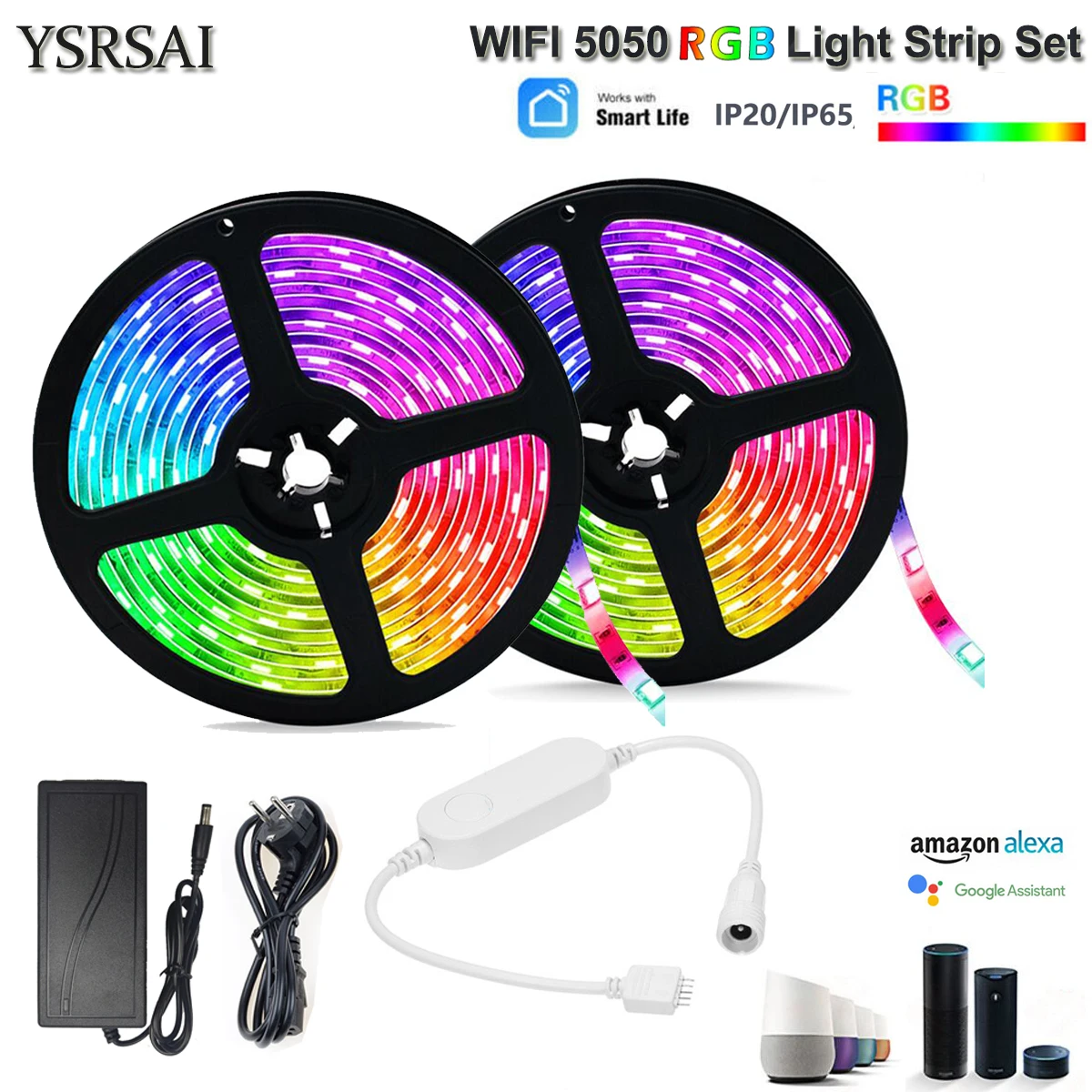

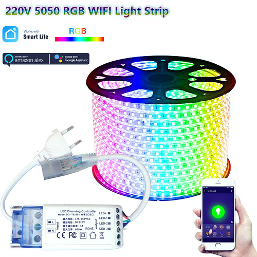

I bought some “tuya working” LED from Ali. At least thats what it says, so who knows :slight_smile:
But, if they can be added to Tuya should i be able to add them in homey? And if yes, would it be possible to change color based on flows? I have only added power plugs so far.
Possibility to specify the tuya version (defaults to 3.1 like it is now).
@Odechr i would say try it as a LSC Led strip.
Ill do so when they arrive :slight_smile: Most likely 1-2 more weeks i assume. Will update!
