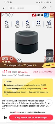

Hey, Does this button work in combination with Homey? and especially the spinning? that the value becomes a variable?
https://a.aliexpress.com/_Eu6VqmN

Nobody will be able to tell you, even if people have a device that looks exactly the same there’s no guarantee it will work (due to TuYa devices changing their internal identifiers all the time).
I have those too but often after several tries they stick, i dont know why. Sometimes homey says it couldnt connect but it did add in the background, just refresh the page/app and it will display.
so there’s actually no point in ordering one, because 90% of the time it doesn’t work anyway?
Just be prepared to be disappointed.
Maybe try reading the first post, that might help.
It doesn’t work!
You need the driver to be added to the Tuya app, and then the developer, with the “Interview Data”, can code the functionality. I have the same button for some time, and never worked in Homey Pro, but it works in HA.
