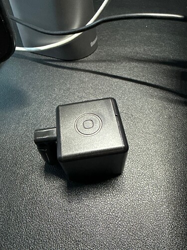

Good morning,
anybody got the finger bot working?
It integrates smothly but than it just do not execute commands neither from a flow nor from dashboard…
Any idea?
TIA
J.
