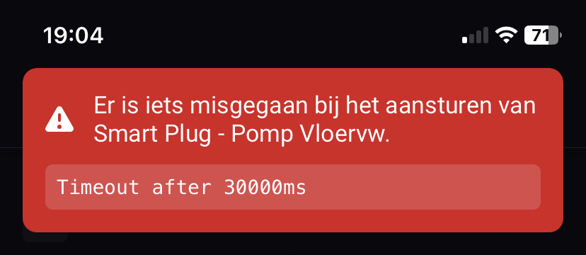

All Tuya Zigbee devices are not reachable. I only have Blitzwolf smart plugs in the app. I’ve tried to start again from experimental to official app. It does not work. I get this message.
Can someone help me?

Sounds like a Homey issue, try restaring Homey and if this does not work try a stronger/better power adapter.
Restarting Homey helped! Thank you!
