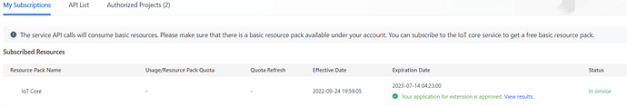

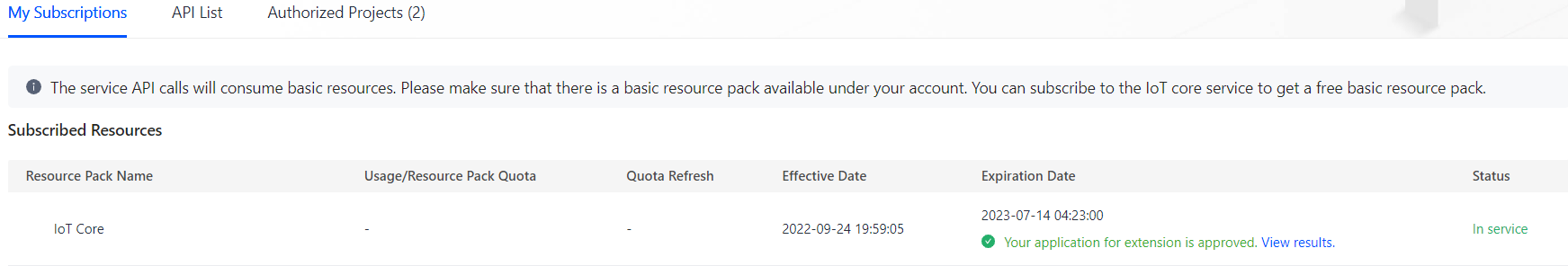

renew your developer subscription. See earlier in the various posts. Ask for 6 month extension. Will be granted within 24 hrs (at least it worked for me 2 days ago)

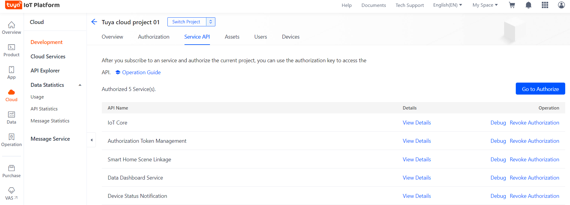

Click on “IoT Core” and renew you subscription. Mine worked just fine (see below)
Thanks. My trial expired exactly on the moment my devices stopped responding. Hope it works and then re-extend after 6 months or try a new account.
Edit 20-01: I was waiting in vain for some days for my radiator valves being able to be reinstalled or an email from tuya but found out my subscrition was succesfully renewed quite quickly already but i also needed to opt for the “Use official only” in the configure app screen. So many things you can do wrong. Now all set again.
