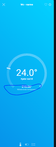

I have a bug in the software for a thermostat that shows 230g instead of 23.0. Does anyone have any tips on how to fix this?
Tuya uses integer values as default. So it sends 230 as value.
But the device should have a decimal factor defined (in Tuya developer page). Can you check if it’s defined there?
thanx. ill check
