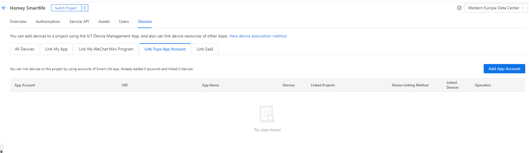

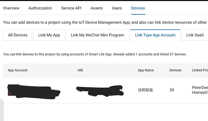

This is my option? Unlink link is present. I use Tuya Smart app by the way

What if you hit âswitch projectâ and pick your other project?
Same thing.
