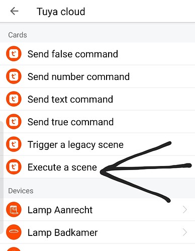

The scenes can be started this way.
Add a Then card > hit Tuya Cloud > Hit ‘Execute a scene’ > pick a ‘tap-to-run’ scene (you made earlier on the mobile Tuya Smart app).

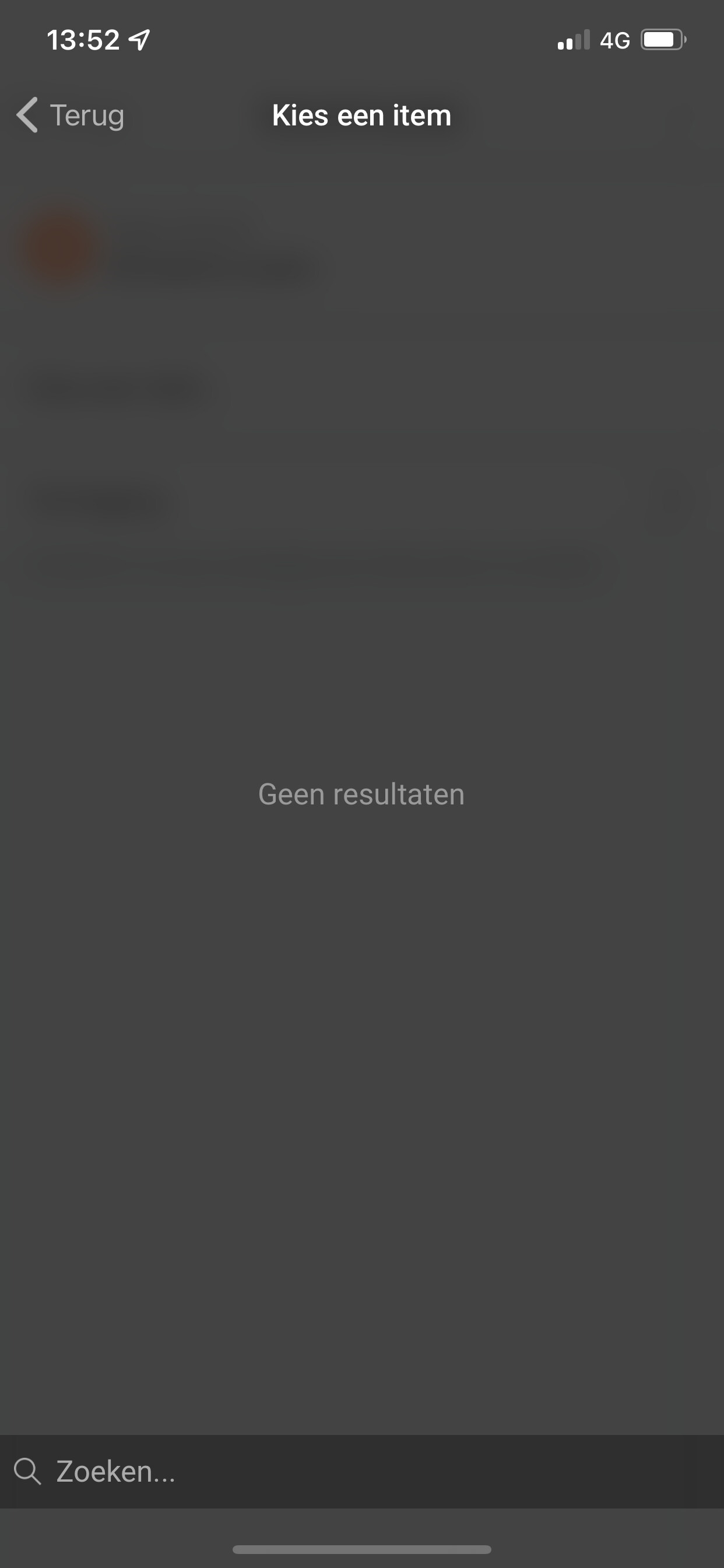

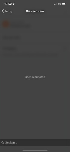

When I click on that it’s all empty
Did you create any tap-to-run scene on the mobile Tuya Smart app?
Did you

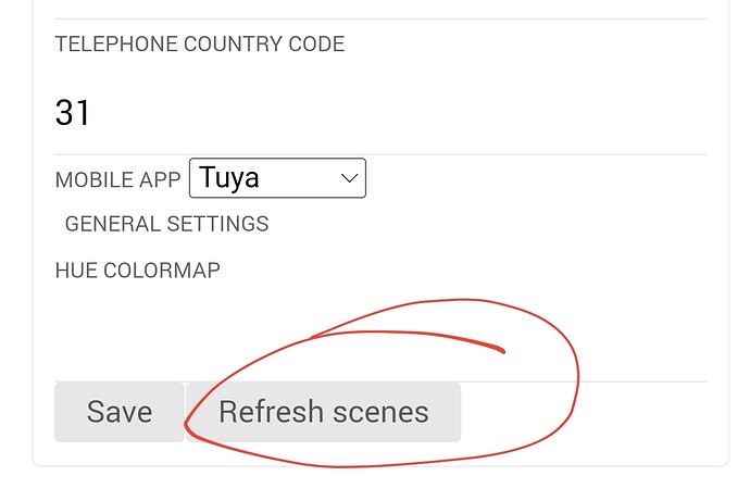

Always hit refresh after you created new tap-to-run scenes
I have everything working again on the official API using tap-to-run scenes. Thanks !

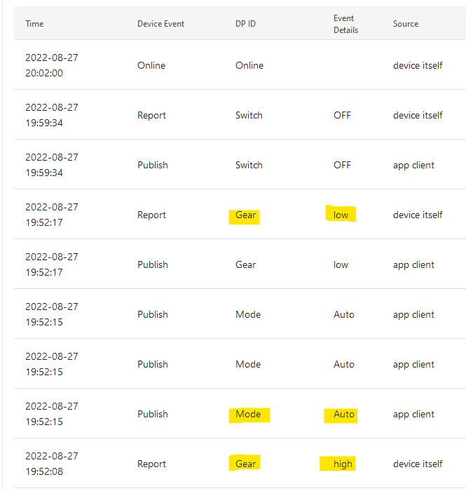

In Tuya app I can select these modes for a heater:
But they are listed in the topic “accessories”.
I would like to get the parameter values to change it via flow.
Btw…I’ll check if I can add the heater device to your app.
PS: Here is the debug log. The mode could also be interesting to log in Homey:

But I’m struggeling with the “accessories” values. The Tuya app is showing entries for accessories (low, middle, high). I can see them in the Tuya debug log. But I can’t see them in device details in pairing dialog.
The decives are retrieved by this.get_devices_by_type(“heater”). The device details are containing the temperatures and modes, but not the “accessories”. I also can’t see them in the console log on incomming messages.
Do you have any ideas how to use these values?
