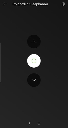

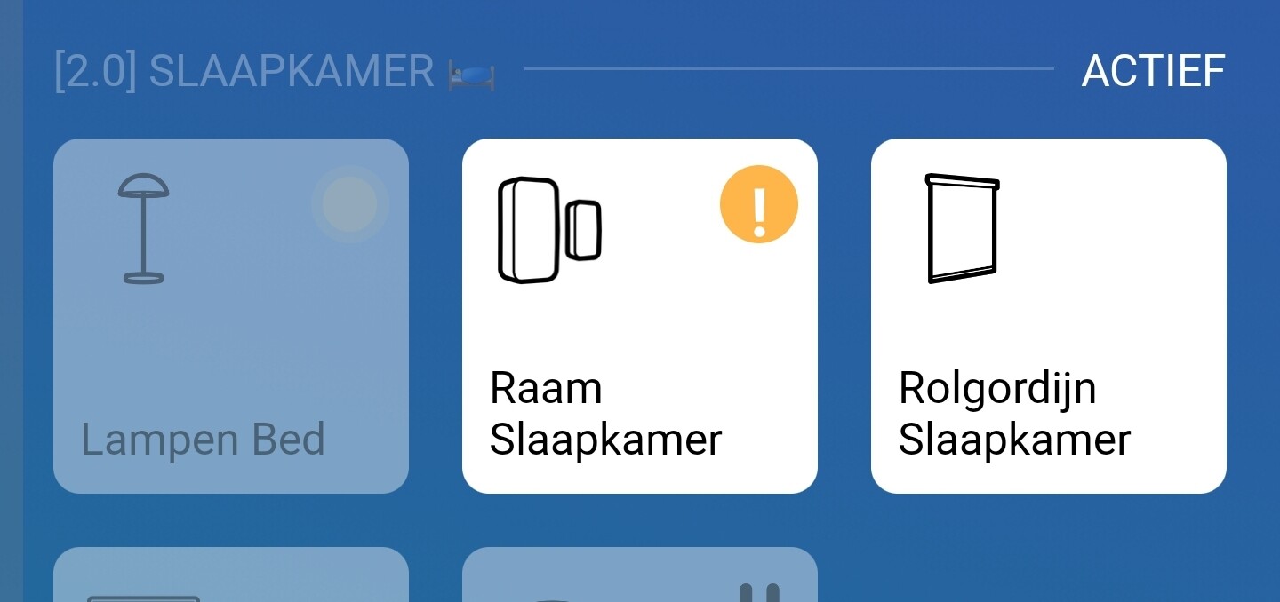

Example for Window blinds control using the new IoT API.
@ Phone Tuya Smart app:
Create 3 tap-to-run scenes for the blinds you want to control:
One for UP, one for DOWN and one for STOP
@ Homey Tuya Cloud app:
Add a Virtual Curtain device. I called it “Rolgordijn Slaapkamer” (Dutch for “Blinds Bedroom”)
Add flows for Up, Down & Stop buttons
Now you can use the device in other flows too, f.i.
