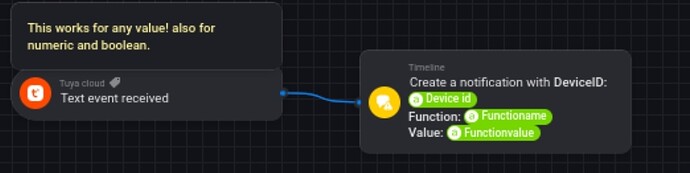

You have to create logic text compare cards
The tags used, are provided by the RAW Commands triggercards:
When you build and enable this flow, it should “spam” you with messages containing the device ID, the function name, and the function value.
Save all the data for later use.
Now you know which device sends which values for certain functions, so you can filter the trigger events to have Homey start things you programmed:

For the first image, created the tuya cloud text event received card, and connected it to a timeline notifiication card.
I created three variables (device id, functionanname, functionvalue) and their default values are the same as the variable name.
I do get homey flooding me with timeline notifications but they all literally say:
“A notifiction:
Device ID: DeviceID
Function: Functionname
Value: Functionvalue”
I understand the second image that tells me that if the deviceid is equal to X then you can do Y.
The problem is the variable @deviceid is not recording the deviceid for the logic to even work. The device id is always the default value of the variable deviceid.
So, if my garage door is opened, and my garage door has a deviceid of “mygaragedoor123” - i assume that based on your first screenshot, the listerner should be recording the deviceid of “mygaragedoor123” into the value for the variable @deviceid - but it is not - the default value remains.

It shows you aren’t familiar yet with a very important part of Homey: tags
Tags are read-only variables provided by apps and flowcards
The tags you see in the notification card of my xmpl flow are so called “Flow tags” which appear on top of all other tags and variables when you’d like to select them for adding.
They are provided by the Tuya “[event type] event received” trigger card.
They become visible by hovering the tag symbol of the trigger card;
Screenvid (hit the :arrow_forward: on the bottom-right):

I wasn’t aware and even when I was looking i nthe tags for the timeline i didn’t spot the variables/tags that were under the section “This Flow”.
I guess that is what happens when tuya spoil things and you get non-techie people trying to do techie things… :slight_smile:
Anyway, thank you for enlightening me on this, I absolutely wasn’t aware of the tags and opens up a whole new dimension for me.
I have updated and can confirm i am now getting proper values.
