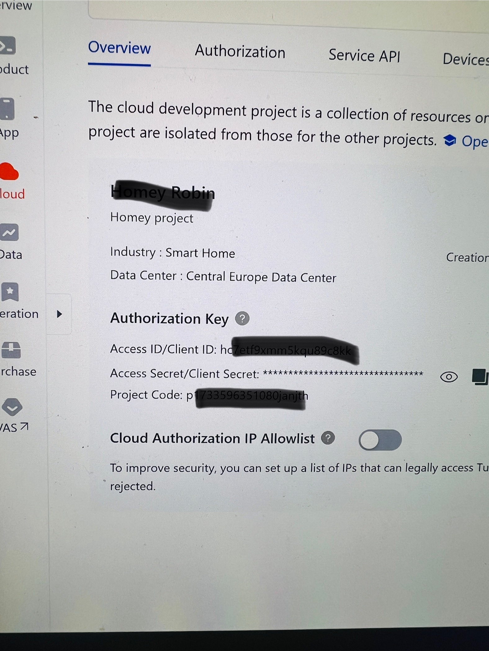

These are the Tuya app credentials? (NOT the developer portal login)?
Is your country entered as, like,
31
Nothing less, nothing more?
Is it the same country code as you entered @ mobile Tuya app?
What datacenter did you select? Central Europe?
Hey Peter -
For simplicity I have the same login-credentials for the cloud (dev.platform) and the Tuya app, which I also enter in the Homey Tuya app.

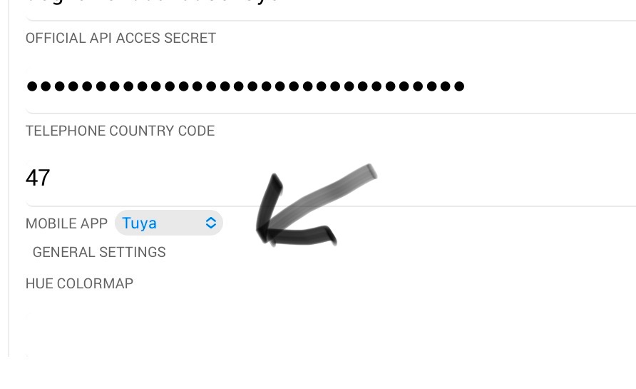

I have tried 0047, +47 and 47 as country code on the Homey Tuya app.
Lastly I have connected to the Central European center.
Thanks.
Wow - I managed to connect.
I switch from Smart Life to Tuya in the Homey Tuya app.
I tried it earlier but not with only 47 as country code.
Thanks for helping.

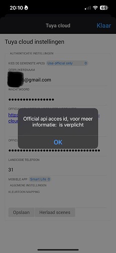

I’m trying to get the TUYA cloud app working on my new homey pro.
I followed all the steps. I got my secret acces ID. But when I fill in everything in homey I get the following message: Official api acces ID, for more information: is mandatory (is verplicht).
Can someone tell me what I’m doing wrong??
Thanx
You have selected the Smart Life app. Have you tried selecting the Tuya app there?
