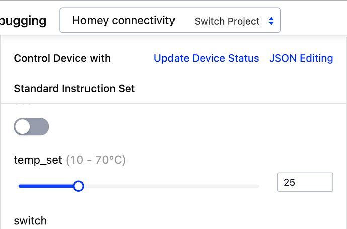

on the Tuya Development website you can access the code:
However you can not update the firmware. I am also thinking the way:
the range of temperatures in the firmware is not of the importance. Important is that the app getting the settings from firmware shall apply the proper divider to display set temp in Homey as well as to allow proper step in the temp adjustment. I think this goes in line with what Peter was mentioning:
You would need to set this in the installed in Homey Tuya device (I guess some devices may vary in terms of their firmware settings�):

If your thermostat should use 10âŚ70° (is this the correct range?), then the scale factor must be 0 in Tuya device settings. See this example:
So it seems, the device definition at Tuya is wrong.
The app uses scale factor 1 (/10^x) and you get 7° in Homey.
The app itself is using the Tuya definition correctly.

I think that you are right that the setting in the firmware may not be correct, however the device itself displays correct values:
Higher temp: firmware: 70 deg C / device 35 deg C
Set temp: when sending a command from the Developer Platform to set for 25 deg C it is set to 12,5 deg C
So the device uses â2â divider.
This was my conclusion that the Homey app may be using certain divider (â10â) - at the set temp 12,5 at the device display Homey shows 2,5 deg C (divider 10):
As I am unable to influence the firmware (if I would the device itself would show wrong number on display I guess) than the only option is to change the divider used by Homey app to display temperature. If I could achieve this everything would work OK (I can of course live with wrong display and set temp in the Smart Life app but that is not the solution I look for âŚ).
