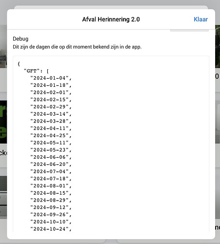

Dates for GFT are:
But no message today, so test also with result no pick-up (but the date is in the list):

Have you checked the data in the app?
There should the available data been visible.
And install the app again without removing it first?
The data are there. I am going to install the app over the app and see what happens.

Mine also, RWM. Strange thing is that the dates are correct. Perhaps the format to check the dates changed?
In the instructions the developer writes that the date has to be dd-mm-yyyy:
Can anyone write down the format of the dates in the app on which garbage is collected.
This is what i see:
Mike, what do you mean?
I only show what i see in my app.
