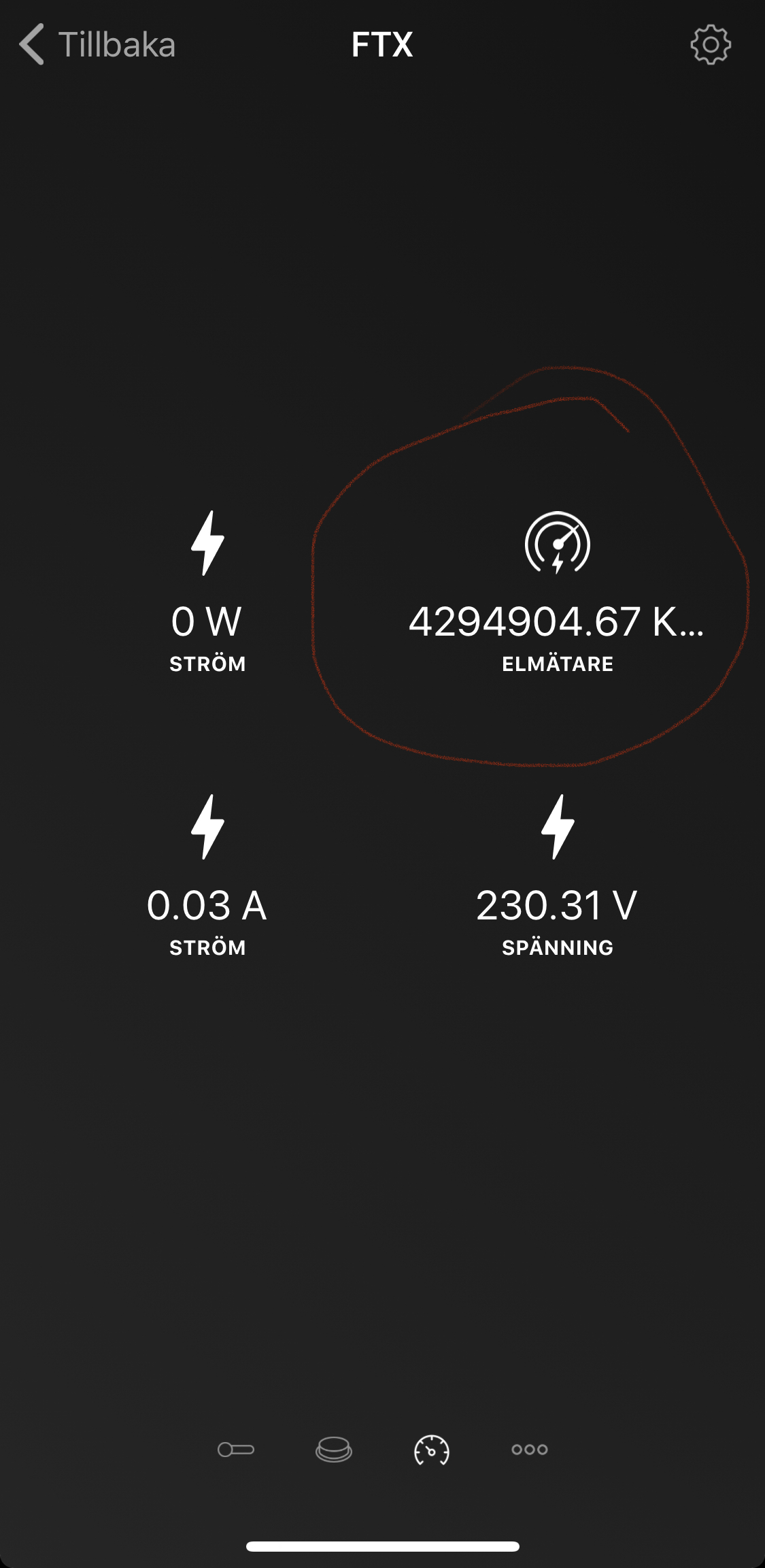

I have problem with energymeter from my HS110. I have tried to do a reset of the energymeter in Homey but the value gets wrong again. The value is high! Is this a value which is calculated in the homey or is this value read from the plug?
Hi Davor,
The app does nothing with the value, no idea where such a value comes from. What is the value in the Kasa app? Any idea what the difference is?
The ‘reset’ in the app stores the value at that moment and subtracts it from the metered value until you ‘undo’ the reset again, this doesn’t seem to work? To be honest I haven’t used or tested this in ages.
Is the firmware of the plug up to date? At one point the emeter values changed. I use a library for the app which takes these firmware differences into account. There is an update available, however it requires at least Node.js v10. Homey is still running Node.js v8 (which is way outdated, the latest LTS version is 12.16…), so I can’t update to the new library. Although I haven’t seen any recent changes in the libary for the emeter values.
So you can check the hard- and firmware version, see if TP-Link has an update, perhaps provide some logging. My plugs still show the correct values, I can’t tell what is going on, sorry.
Hi!
Thanks for the support. I tried to do a reset and undo and after that it works fine.
I didn’t know that I need to do a undo as well.
Thanks!
