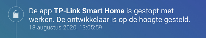

I have finally my complex laundry flows working, now keeps the tp-link app crashing (“onverwachts gestopt”) and devices are offline.
I submitted an issue. Am I the only one?
I have seen the issue, without additional information it is completely useless. What do you expect me to do based on the supplied information (‘ The app keeps crashing on homey. At random.’)?
No Homey or app fw/sw details, no info on what you have tried to do about it, fixed or dymamic ip asignments? Did you go through the topic?
Of 1250 users there are a few (a handful, maybe fewer) that have intermittent issues with the app crashing. In most cases it seems to be related to network issues. As explained earlier, try to avoid dynamic ip assignments, instead use static ip reservations in your dhcp server.

I understand that it is completely useless although the Homey app says it did send a report to the developer. I could make a diagnostic report but I don’t know if you’d pick up on that or that I need to do other things to provide you the right data to analyse.
My post wasn’t a rant to your app, but merely a start to get a problem fixed.
You don’t ask me wait you need, so I’ll ask you explicitly: what do you need from me to analyse this? The crash happened again, yesterday, so… (with a fixed ip-address by the way, fixed in router/dhcp, not static)
If you need it, this is the notification
If you need it, this is the diagnostic report code: b8b5bc89-0d4e-421c-b948-b218696785d1
Homey Pro, latest non-beta firmware.

@anon61197305, while testing the app I happened to run into the issue you were/are experiencing, and I was able to reproduce the issue. I have added a workaround in the new version. I haven’t seen the issue since.
Note that the issue only occurs when using the ‘dynamic ip’ option in the advanced settings, and then only when devices are offline (or otherwise unreachable for a longer period of time). If you still have the issue, you may want to give v0.1.12 a go.
