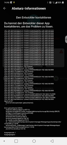

I will change my network and make a special SSID where the tp link’s are connected to. It could be a case that they are hopping between AP’s continuously. But all worked fine, until the homey was updated to v3.1. That’s the reason why i made the link between the problem and the update should be the reason.
Also the hs110’s are connected to the tp link Kasa app, where they are always connected and never gave any problems with disconnection or something similar. Let’s hope the dram.js will bring some results.

I have discussed the issue with a developer who knows a lot more about node.js then I do. The probem is that a socket is created but closed (for unknown reasons) before the client can use it.
Unfortunately, the error is thrown in an async event handler, which means it cannot be caught in the app.
It is possible that Athom changed something in 3.1.0 that causes or makes the issue worse, but that’s something we’ll never know, there’s no logging or debugging that can be done (except by Athom, but they are busy redesigning the appstore :grimacing:).

Again for your support! I changed my network so the plugs have a static IP address now. The dynamic ip option was not working as i expected. From now on with the static ip’s on the plugs the app is not crashing anymore. I will keep you in touch when it is happening again, but for now it looks good😃

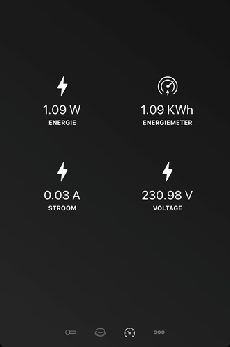

@Dumacos, if you have a HS110 plug, you will see the power usage in the mobile interface, in https://insights.homey.app, and you will have flowcards which allow flows to be made based on the power consumption.
The HS100 plug does not include power metering capabilities, and neither does the Homey driver for the device, so no power metering output will be logged or displayed, and there will be no power related flowcards.

This raises the following questions: can you turn the plug on and off through the Homey app? Do you see the ‘energy’, ‘current’, ‘power’ and ‘voltage’ symbols like in the screenshot (but then with empty values I guess…)? If the view is not present, it would seem that you are using the HS100 driver.
Did you use the auto-discovery feature when adding the plug to Homey? Can you check the type, version and firmware details in the Kasa app?
Screenshot_20191122-122947_Homey|249x500

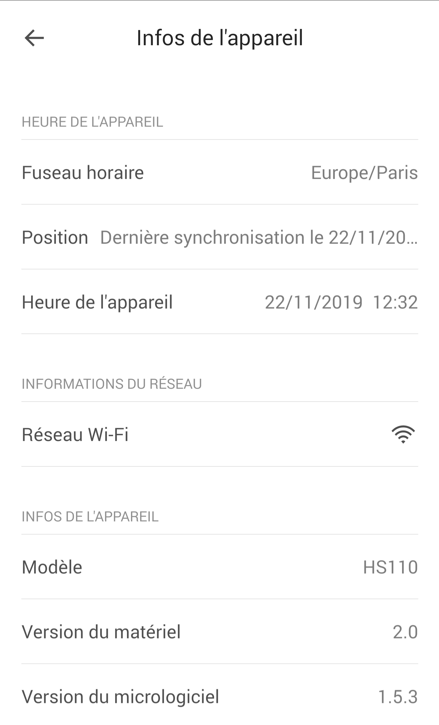

I confirm it’s HS110, i share a screen copy about the homey app (empty) and data from Kasa (I have data on their app)
Auto discovery didn’t work, I filled IP address manually.
Strange situation?
Thanks
@Dumacos the most logical explanation seems to be that you selected the HS100 driver instead of the HS110 driver. Try to add another TP-Link device, select the HS110 driver, and then it should auto-discover the plug (the HS100 driver cannot auto-detect an HS110 plug).

@Dumacos in that case I have no idea. I have several HS110 Hardware version 2.0 / Firmware version 1.5.4 myself, that shouldn’t be a problem. I have just taken a brand new HS110 and included it without issues, it immediately showed power usage data.
Running the app from the cli (see [HOW TO] CLI install method) will give more output that might help pinpointing the issue. You can also try to use one of the many other tools/scripts to connect to the plug to see if you can figure out what’s going wrong.
