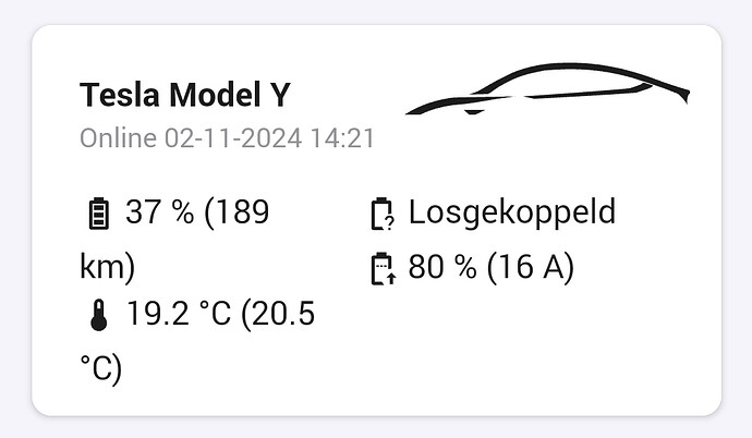

I also like the Tesla widget. But I am missing the icons on the bottom row.
I am now on app-version 1.11.4 (but same thing on the 1.11.3 and previous versions).
Am I missing something?
@GRat @Bram_C
It seems you are using big fonts? If I’m right, Athom made some changes in the widget API (CSS styles) so widgets are using system font size. And that seems to increase the font and thats causing line breaks.
I need to check possible workarounds…
Thanks for your reply and that makes sense. As far as I know, I haven’t changed my font size and it looks like it is set to standard. I have the same issue on both my phone (Galaxy S22+) and tablet (Tab A). Actually, it is even worse on my tablet:
