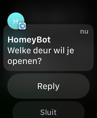

Maybe I am missing something, but when sending a question to my iPhone / Apple Watch with 3 possible answers results on my watch in a question with only one possible answer: Reply (or Quit). When I use Reply, I can just see some predefined answers from my phone. Is it possible to have the predefined answers available on my watch as well?
That something Telegram has to program. I can’t change anything related to the telegram app itself
