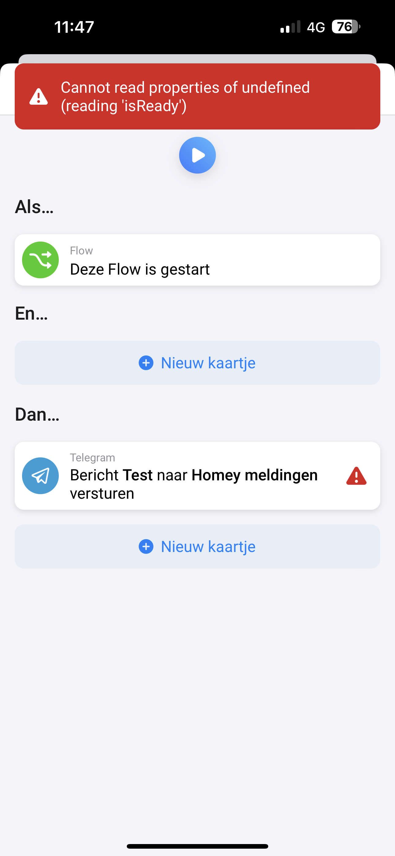

I have the same
Same here:
Screenshot 2023-04-03 08.01.47
I got the same, but somehow re-registered the Bot and it starts working again… what was interesting, it keep sending the messages but the “test” flow was not working like in your examples.
Unfortunately can’t share diag as I rebooted while ago…
Hello can you share how you re-registered the bot? Thnx
I Get exactly the same error.
The last message I received was yesterday around 10 in the morning. CET
I should have received at least 1 message after that, and a whole bunch this morning.
This is the exact error.
As the Telegram Homey app was updated yesterday at 15:41 CET (for me). I guess it is related to version 2.3.1.
@spkesDE, do you want me to test something particular?
Chat with @BotFather in Telegram and try via /mybots … yesterday it was not working, today I had to type /start in the given Bot channel… I also re-saved settings of Telegram etc. - it was more actions required.

I see this happening.
Advanced flow, error shows in timeline when started from Chrome flow editor.
Advanced flow, error does NOT show in timeline when flow started from Flows in Homey Andriod App
Simple flow, not sure how to get the error to show up in timeline
None of them send a message to Telegram
